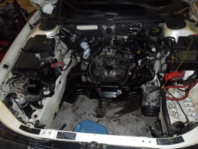

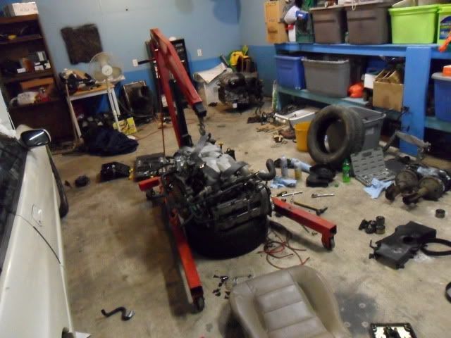

Wrapping up the install of my 11.4:1 compression eg33 with ported heads and intake. Swapping over components from the stock engine to this one. All was going well until we pulled the stock engine... and left the motor mounts behind. Seems they were a little rotted out. Once the engine was out, I looked down and was rather surprised to see that the bottom of the mounts were still in the engine bay. They tore off of the top mounts. *grumble grumble* On the plus side, I learned something. I had no idea that we had oil filled motor mounts! So, I ordered a set of urethane STI mounts and will modify them to fit.
For some reason, I just cant leave stuff stock
You will need the brackets from the SVX motor mounts. The metal part that the part with the rubber stuff bolts onto. What is done when using STi mounts is make a ~1/4" spacer of some kind, and slot the bolt holts a bit on the SVX brackets, and then use the actual mount part from the STi mounts. Get my meaning?
Yup. I know about the original brackets for proper mating to the engine. Im just not using the 1/4" spacer though, as for my application, lowering the engine would help a bit with the cars roll center. Every little bit helps.
