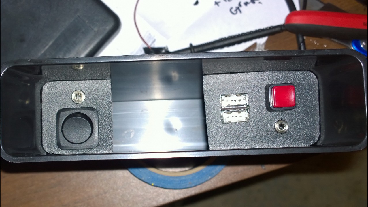

Ok so I finished a mockup of the kit to show where I'm at now. I actually found more info on the CD player's wiring, so I believe I should be able to make it totally plug-and play, including the USB part, just need to test it out in my car to be 100% sure. If someone at Reading could show it off to some of the people there who still have their stock radios, I would be really super appreciative.
On the left (upside down if it were mounted on the right side) is an example of the switch + aux jack only, and on the right is an example of the switch + usb charger + jack. There are actually a lot of options to choose here, they can be mounted in the left or right side of the pocket, and the switch, jack, and charger can be moved around in the panel wherever pretty much. I'm going to try to find some small black rocker switches like the one on the left that will fit with the USB charger better, I think they look better. Also going to use pockets that are more square inside instead of round, these are tough to get the edges just right.
The final versions will have another panel alongside the front panel that goes to the back of the pocket to keep stuff out from behind it. Final version will also be a bit more polished (I promise), and I can line the bottom and sides of the pocket with felt if people like, I plan to do that with the one I put in my car to keep the phone from getting scratched whenever dust and stuff gets into the pocket.

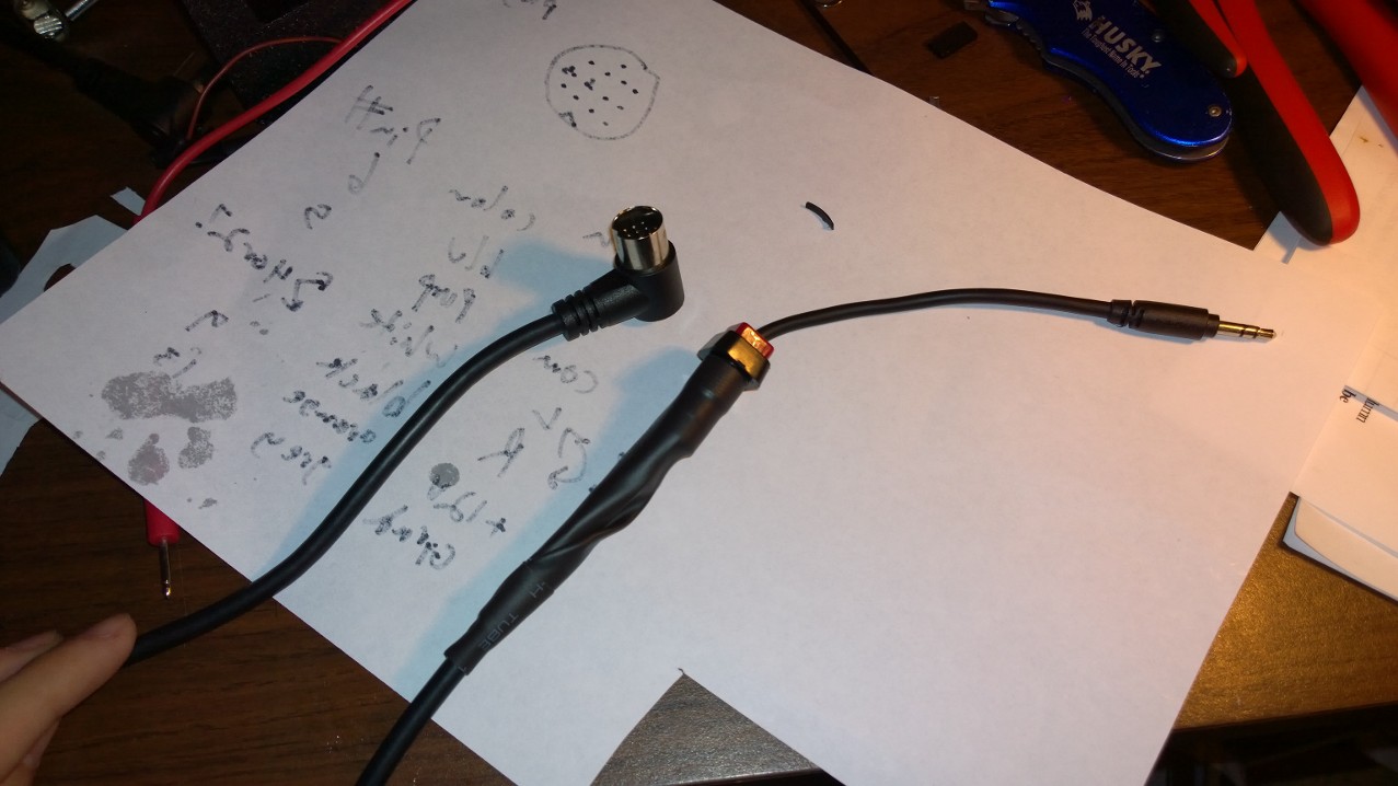

Ok here's another option. Just an aux cord, with the button inline, close at hand so you can press it when you plug it in. These would be only $20. (Note: I'll find heat-shrink that doesn't have anything printed on it, will look nicer.) And instead of a pocket you would put something else in place of the CD player, such as gauges like in my other car or a slide-out cupholder like this: http://www.ebay.com/itm/Universal-Ca...-/331156375007 Or hopefully a nicer looking one if you can find.
