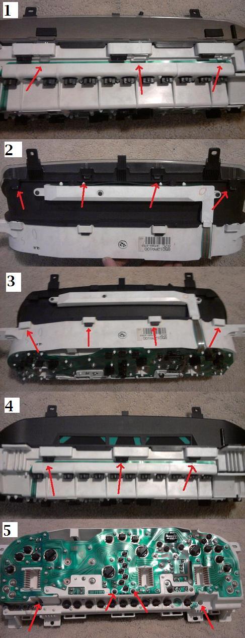

Here's the how-to and photos to replace individual gauges in the gauge cluster.
First remove the cluster (that's pretty straight forward)
Unclip and remove the clear plastic cover (red arrows show tabs to unclip) pic 1+2
Remove screws in pic 5 and then unclip tabs (pic 3+4) and remove black cover
Be mindful of the small filament still holding them together (green arrow)

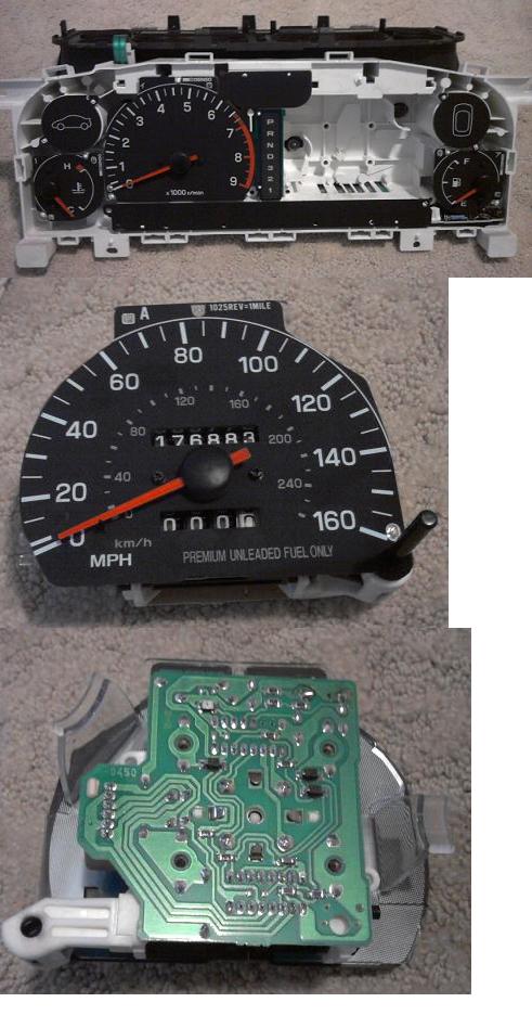

Remove the 4 screws shown in red (speedometer) and the gauge can be pulled out the front of the cluster. This can be done with any of the gauges. There is nothing to unplug as the screws are what conducts the signals to the gauges.
Now the gauge out of the cluster. As you can see, this works with any of the gauges:

Really? I assumed it would be a PITA and have avoided replacing my "D" light. How easy is it?
The bulbs can be replaced without taking the gauge cluster apart. The gear selections are the 7 black twist knobs on the back center (Photo 5). I have plenty of bulbs left over from the old cluster if you need one.

Easy, you take it apart to this stage:
(top pic) only without taking out the gauge. There is a little clear plastic panel that has the PRND321 printed on it that just pops right off.

Re: Gauge Cluster swap
Have you tried taking the speedometer apart further? My speedo is reading slow with an accurate odometer, and I am wondering if the speedo can be repaired.
Bill Z
Is it consistent or speed dependent? (eg. always 5mph or 10%)
If it's consistent you could move the needle. If not then make sure the speedometer is screwed in tight (4 screws).
