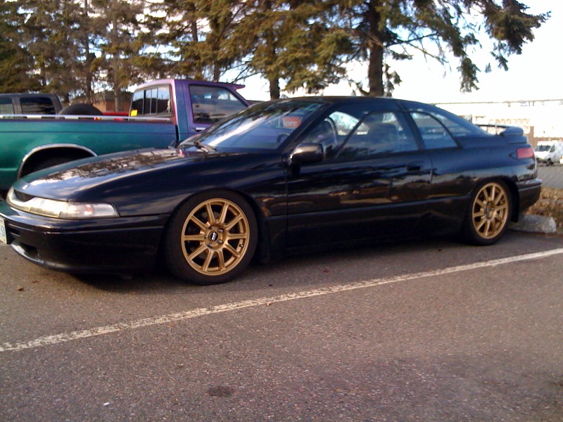

As stated, in the USDM the SVX did not come with active rear/4-wheel steering. It apparently has a manner of passive rear steering, which I believe implies that the alignment geometry is calibrated to generate some toe angle as the suspension compresses, effectively "steering" the wheels to a degree. The rear wheels rubbing while steering is probably just because the car is leaning over in the corners. Cut/clamped or not, the stock spring rates aren't exactly conducive to flat cornering.
My car rubbed for a while after lowering it. Then the tires wore through the plastic wheel well trim. All is now groovy.
