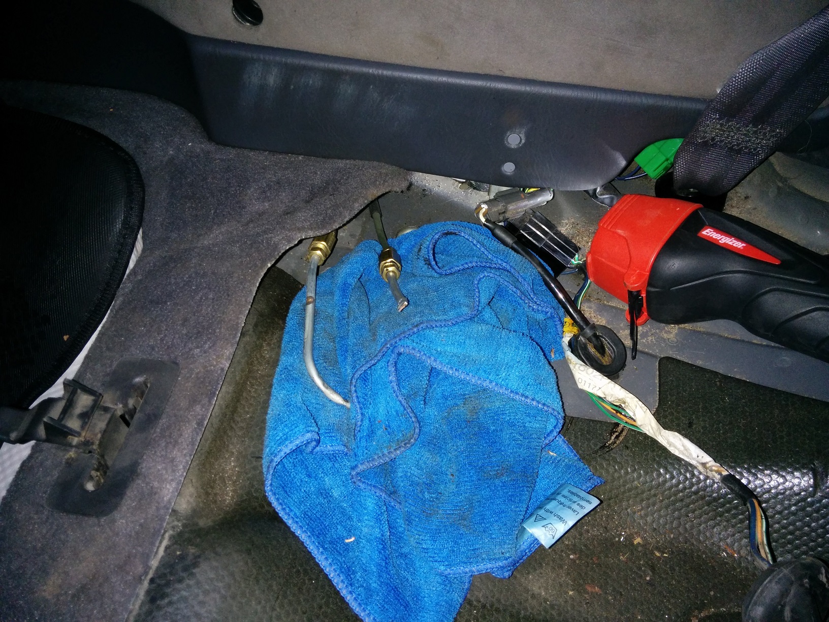

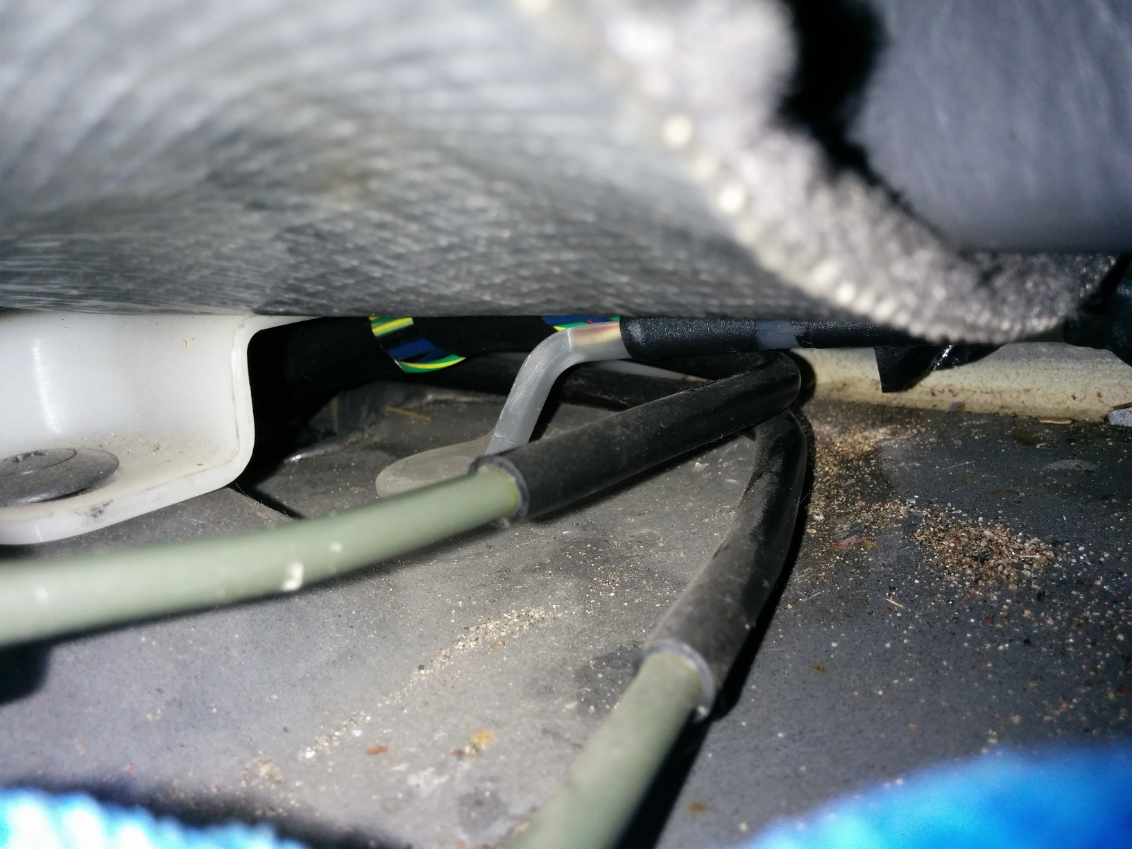

Which interior brake line feeds LR/RR wheels?
I'm finally putting my car back together but forgot to make a note of which brake line went where. The reason it's hard to tell is that the last person to replace these spliced into the existing lines. The only determining characteristic I can find is that under the rear interior side panel (armrest) where the lines point in a front/rear direction one runs above the other. Looking at the parts diagram it seems to indicate that the high line will operate the RR caliper and the lower line is the LR caliper. Can anyone who's had these apart weigh in with some advice? Or, if someone has their rear seat removed could you maybe take a quick picture of where the lines go through the floor?

The top one goes to the driver side. Check out my pics in the thread: "rear brake line routing near gas tank" post #8
