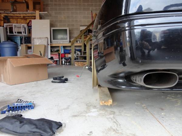

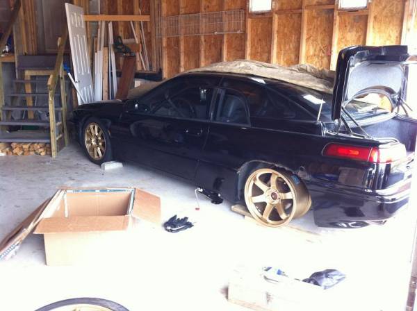

Ever wonder what some 18x9.5 +38 wheels look like on an SVX?
Sorta like this:

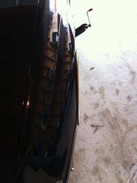

Rears line up perfectly with the rust. I mean body. I really have to fix that...

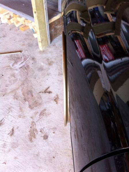

Fronts are not quite as nice. Needs camber, currently running ~-0.5 degrees.

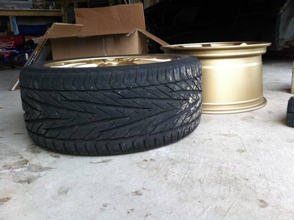

This is what they look like compared to my 17x8 STi wheels (Sidenote: General Exclaims. Never again.):

How is the inside clearance?

Quite a bit actually. Mind you, I have coilovers, so I've got more clearance than someone with stock struts. I'm going to try finding a 265/35/18 used tire for free/almost free to mount and check again, but I think fender clearance is going to be an issue before the strut gets touched.

I like the look, actually. I don't always like over-aggressive treatments.
I wonder if there are any mild front fender arch extensions that would fit the SVX's front fenders. The rear clearance doesn't look too bad, maybe rolling the fender lip, when repairing the corrosion you mentioned.
Something like these Chargespeed generic fit fender flares.
http://www.bodykits.com/Charge-Speed...SAOF02/624194/
I am not usually a big fan of that stuff... but I could see it looking mean on the front of an SVX, with the boxed flare rear fenders, and the dished wheels. Budget for wheel bearings. Lots of wheel bearings, maybe a set of spare uprights, to refurbish with new bearings while they are off the car, and rotate them back onto the car when they start complaining.
One thing, though: PLEASE don't stretch narrow tires over those wheels. Equal width, or wider tires than the rim width look and perform better.

I just saw your comment on the General Exclaims...
Wholeheartedly agree. After 2 sets, the second set under begrudging acceptance due to the price, and being able to use two of the first set as ready spares... no more.
ContiExtreme DWS on the SVX and Legacy now, so far much, much better, and they would have to try very hard to wear as badly as the Exclaims wore down. Bad uneven wear, and LOTS of road noise.

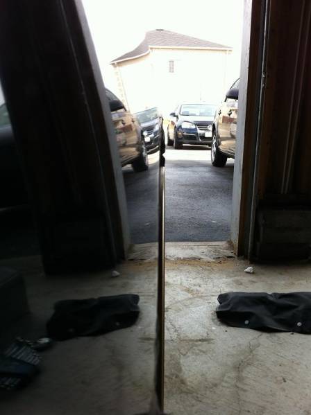

At first I was like why do you have a huge mirror in your garage sticking halfway out your door...
That sheit is flush, son! Would be baller status if you have some edge guards.

Actually the wear is the one good point for my Generals. With 4 years and 25 or 30,000 km on them they've still got plenty of tread left. What I hate about them is the mediocre grip and especially the flimsy sidewalls. It was acceptible on stock suspension, but with the coilovers transferring so much more energy to the tires they just can't keep up. I've been running them at 40 PSI front and 35 rear in an attempt to get more responsiveness, but it's just not happening.
