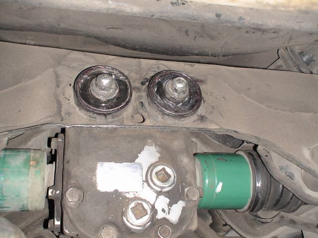

can someone post a photo of location ??? so I can check where to look..

it is where the two mounting stude on the back of the rear differential go through the rear subframe and no they are not part of the kit from Poland...

Re: Rear diff bushings
After having bought some from a recently closed shop, last summer.
If i had to do it over again i'd make my own for like $40ish.
2 different sized exhaust tubing, 1 size (2.25"? Id' have to check) to press out OE bushing and press in new and the one for the actually bushing housing. That and OE center pc. and mix your own polyurethane (check ebay).
Made my press outta 2 plates and long bolt & nut & exhaust tubing.
