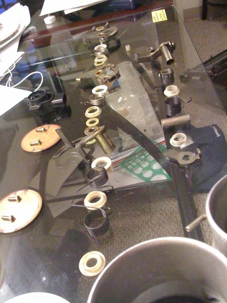

And if you've ever wondered what goes into our throttle bodies....

After taking mine apart I can tell you it would be a ***** of a time porting the TB properly to take larger butterflies. The throttle shaft is staked in place and would be extremely difficult to remove and re-install properly, and with it in place it's not possible in any practical sense to open up the tunnel any more.
