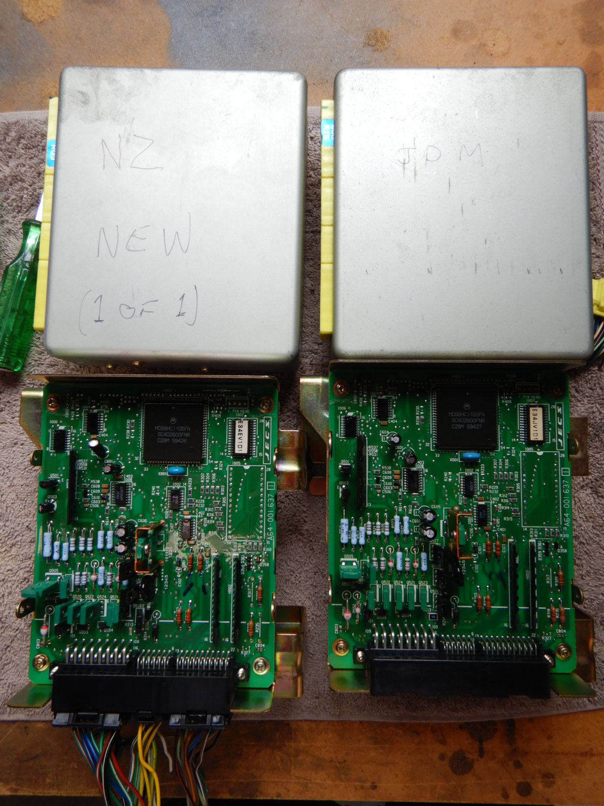

Well my NZ new 95 model must NOT have A4 connected to the module internally - as I do not get the power light coming on when pin A4 is shorted to GND ?
So now I need to remove the module and swap it out with a JDM version ?.
Anyone else had a similar issue ?.
Anyone know where / what components are connected to pin A4 within the module - that way I can conform by opening up my module to check what is missing?.

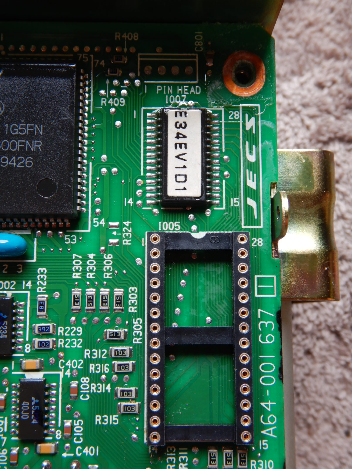

Australia/NZ model has a similar TCU to the UK model. Pin A4 activates "Economy" mode not Power mode.
If you want a power mode switch for that, you have to chip the TCU. I did a few of these for people a long time ago, but I don't have the time anymore.
As far as I remember, a JDM TCU won't work because the front speed sensor is different. Plus there are C solenoid differences pre and post 1995. People have overcome these problems, but it's not a easy swap.

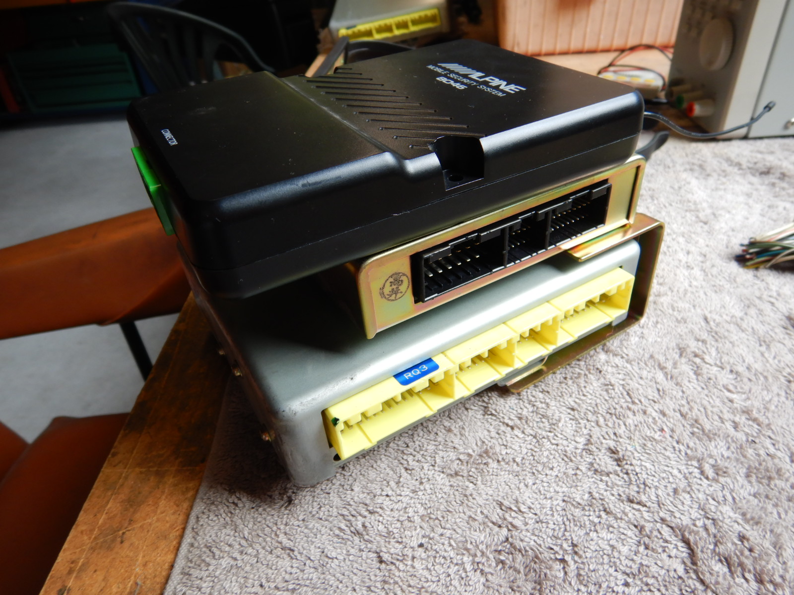

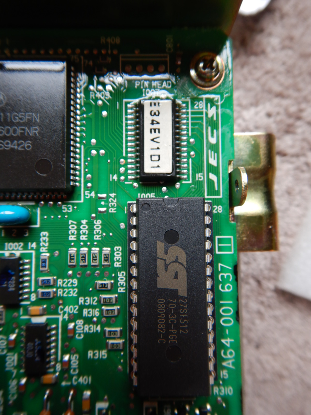

Yes you did a ROM for me about 6 years ago - finally just put it in, it works a treat (well the power light works fine) - many belated thanks.
Now just got to get all the interior stuff back in so I can take it for a drive.
