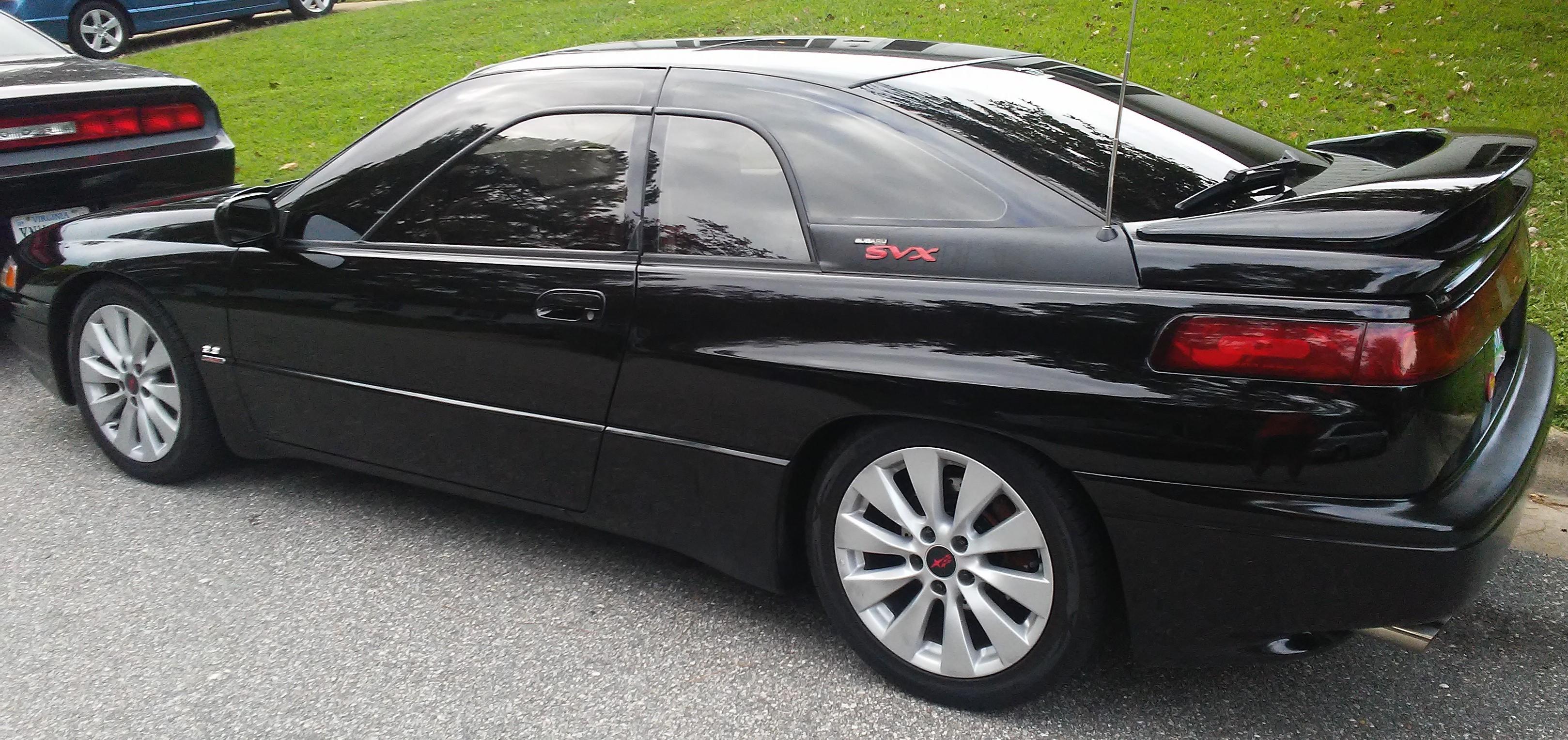

Got the windows tinted today. The rear glass and stationary glass on the sides were done with a 5 tint (very dark), and the roll-up windows were done with a 50 tint (max here in VA). The dark tint on the stationary glass on the sides really emphasizes the roll-up windows, the tint shop took pictures of the car before I drove off in it.
I'm just wondering how long it will take before some sort of law enforcement authority pulls me over for having the dark tint on the "side" windows. This will be one of those instances where it will be subject to interpretation and discretion, but the actual roll-up windows are legally tinted, so we'll see how that goes, if and when it happens!

Looks good!

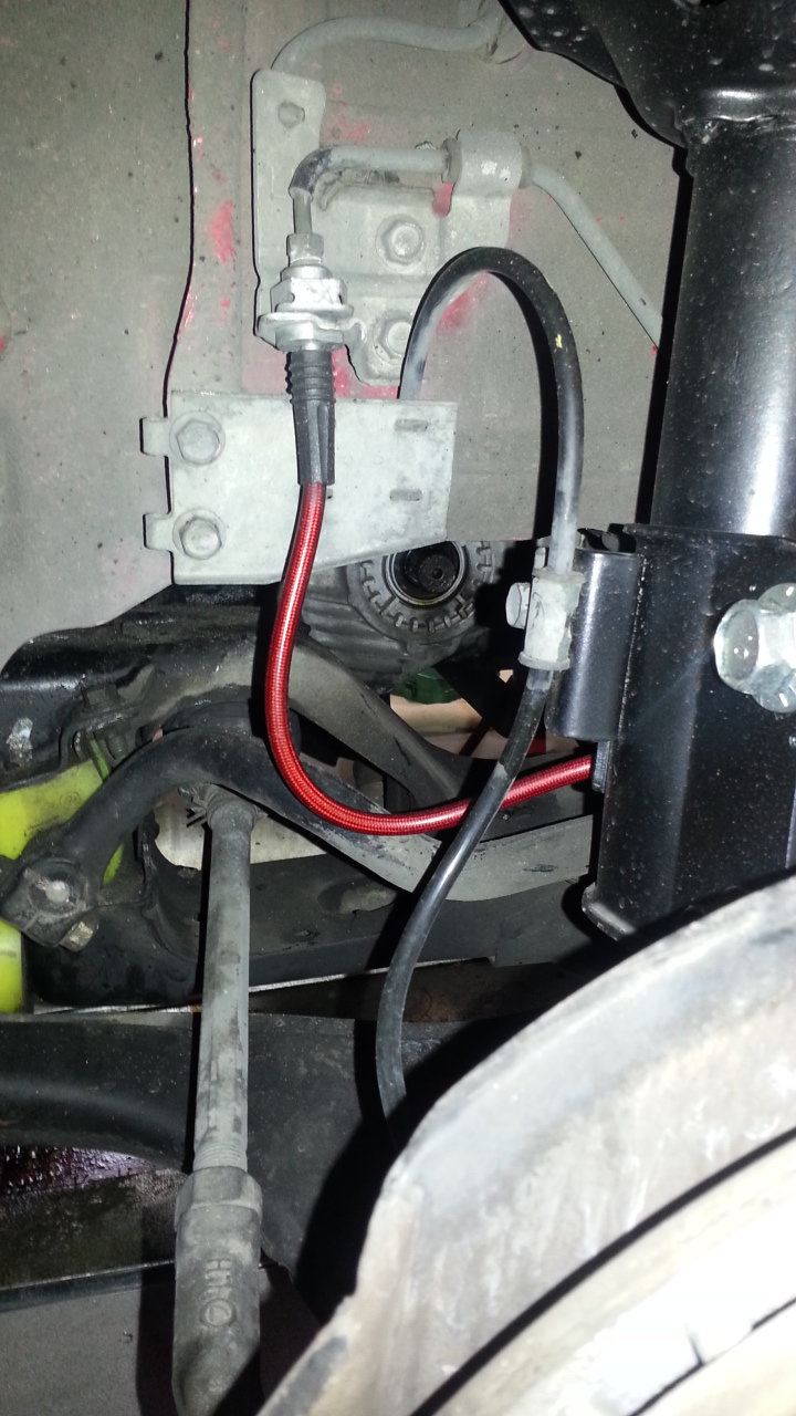

While replacing front BJ & CV boots I found the leak(s) from both engine sump and the gearbox sump + 1 in-hex allen bolt at lower front of engine.
In-hex bolts all now done up to 35 Nm
Engine sump 10 out of 12 bolts done up to 12 Nm (rear 2 will need to be done while on hoist).
Gearbox sump 8 out of 16 bolts done up to 12 NM (the rest I should have looked at when car was all in the air - so another hoist job)

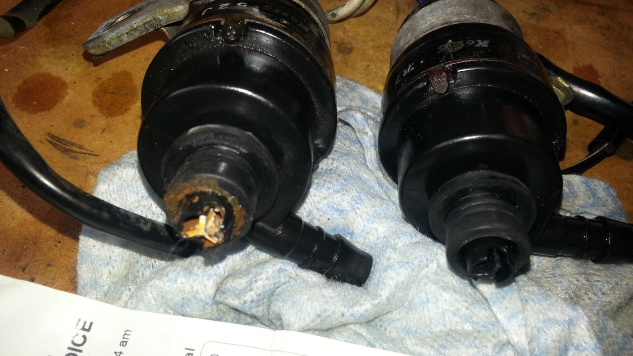

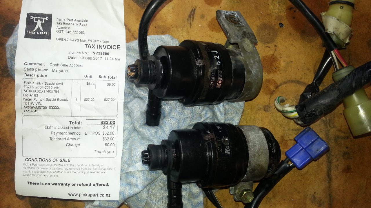

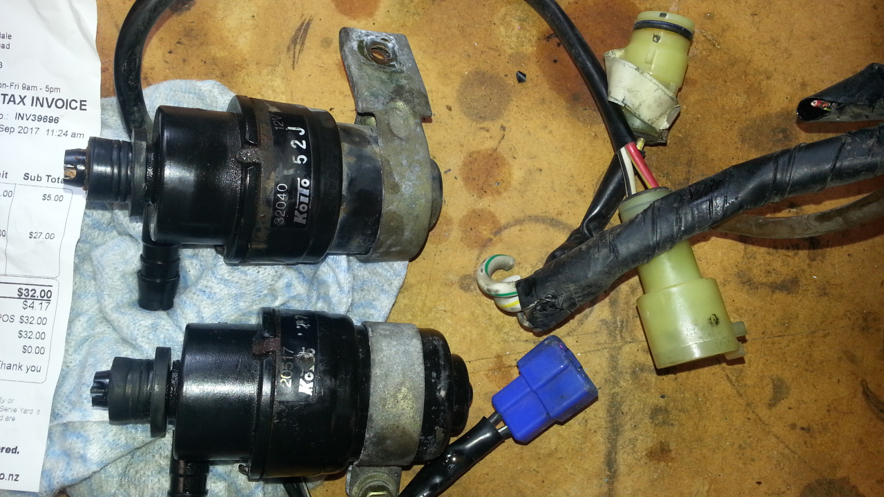

But best news of all - I picked up a working headlight washer pump - from 1991 suzuki escudo - picture attached, filled it with WD40 for an hour and away she went as smooth as silk, just have to modify the 2 pin round connector (leaving it in place and adding a rectangular 2-pin to match the SVX loom).
Better to pay NZ$27 from Pick A Part than over NZ$140 for the same thing from local Subaru Shop - on back order.
