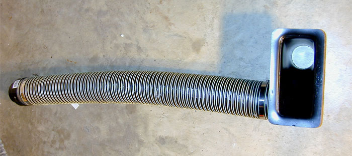

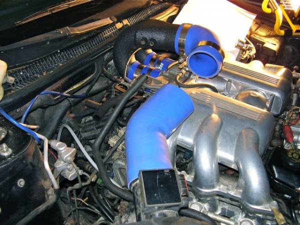

Quick pic with my cell phone. Thanks to Gene for an awesome and cost effective mod! Thanks mate!!!!
I used the small grey 3" MAF adapter from auto zone and redrilled the bolt pattern to fit the stock MAF and trimmed off the corners.
I also used a K&N E-0773 filter.
On Gene's parts pic I used the small L shaped bracket and re-drilled the hole about 3/4 closer to the bend. Stuck the small end under the hose clamp closest to the inner fender and bolted it to the rubber mount where the air inlet tube used to bolt on.

So you have a cone filter is inside the passenger fender?
How do you clean it/install it?
Do you have to remove the fender or does the filter fit through the hole in the fender from under the hood?
Doesn't the stock air box take in air from the same hole your using to stick the cone filter through?
So why not just leave the stock box there and put in a high flow rectangular filter in it?
Are there any #'s for replacing just the accordion plastic to the MAF compared to a full intake into the fender, on the SVX?
I know on my 2001 Impreza, removing the box and going to a pipe with a cone filter on the end decreased low end torque.
That the air in the box at the ready helped the performance, that is why the "gonzflow" style makes use of the stock box and filter, instead of a pipe and cone on the end.
Then again, the air filter box on my impreza was at the motor, not the fender, and I didn't have this MAF stuff to deal with.
I am just wondering if its worth the trouble switch to a cone in the fender.

You need to remove the splash shield in front of the front tire to access the filter, not a big problem. It will all be accessible from under the car not in the engine bay.
The stock box has a resonator in that location inside the fender, that resonator decreases air flow to the stock box. Remove the resonator and keep the stock box is an option but the main benefit of this type of CAI is smooth air flow from the outside to the throttle bodies.

No that is not right. The stock air box takes cold air in from under the front, and suppresses the sound. It does not restrict the air flow.
The only advantage of modifying it is to say" look at what I've got."

Easiest way is to clean it when you rotate your tires... you do rotate them every other oil change... yeah? Take two minutes and a 10mm socket and ratchet to access the filter.
Yes, but what you don't see is the fresh air inlet makes a U shape inside the inner fender plus the resonator chamber. The inlet sets about even with the back of the headlight.. pretty close to it too.
The accordion bit is there to give the intake some flex since the engine isn't sold mounted to the chassis. If you just want to replace that bit, I believe SVX Motorsports Warehouse has a pipe.
How do you know that? Did you swap them out on a dyno between runs? I ask because in my entire life I cant say that I have ever seen a car not benefit from a "free flow" or CAI... unless the system was flow limited further down stream. Furthermore I assume you are speaking about "peaks". What about area under the curve? Sometimes you may trade a bit of HP for TQ or vise-versa but typically the gains far exceed the any losses.
I think so but YMMV
