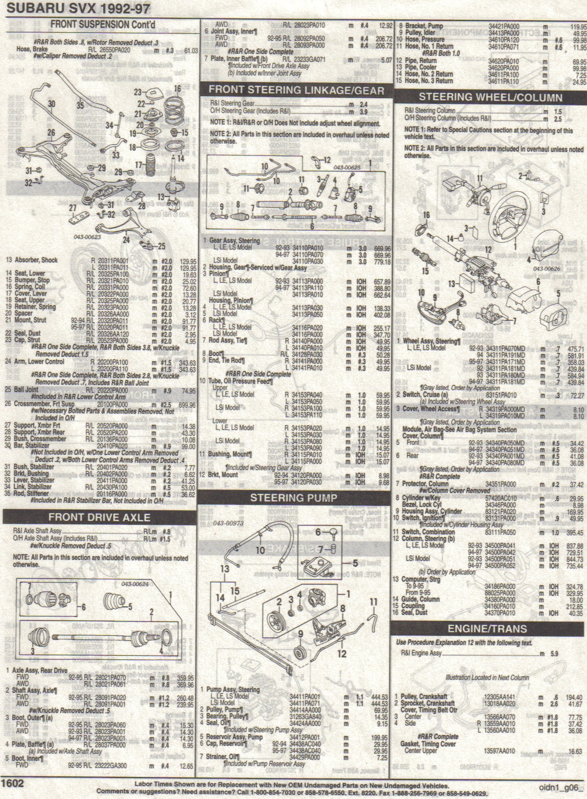

Originally Posted by Pierre-Olivier View Post
Hi Manarius, what is CV joints and boots ?
Do you have a pictures ?
Thank.
Pierre-Olivier
here is the link from How-To_Doc:

Originally Posted by svxwill View Post
From that picture, it would be the rubber boots on the "Front Drive Axle".
Thank you very much, what parts numbers are to be changed on this link ? ----> http://www.subaru-svx.net/forum/show...ont+drive+axle
Well, generally it would be parts 3 or 13 (assuming you determine the axle boots are torn). Just the axle unit itself. They can be had for $70 at places like Autozone and Advance Auto. I don't know what kind of parts stores they have where you're from, but I would think you'd be able to order the axle from something equivalent to those.
