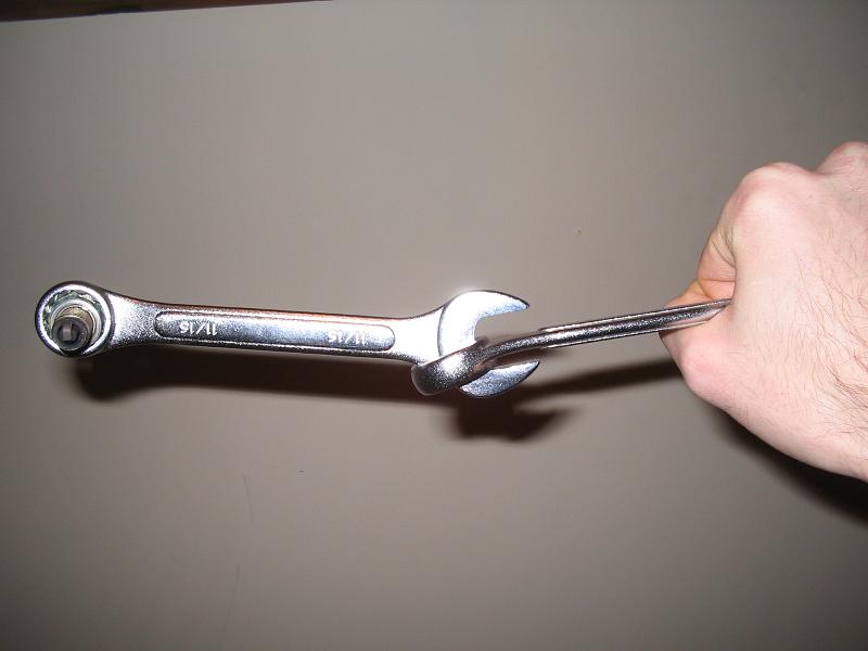

budfreaks tip is a great one to know... but without a diagram most people I'm sure won't understand what is being described... Don't just roll your eyes when it slides off the first time, play with the wrenches to get them lined up right, it is a great tip.
Yeah, I couldn't think of a way to really describe it and I don't have 2 wrenches handy to take pictures for a clear understanding.

Old 02-21-2007, 01:07 AM
This is (I believe) the trick Budfreak mentioned. Very handy when you've already got a wrench on something and need some more leverage.
Note: Spark plus is used from demonstration only and is not included in kit.
As shown here I would be pulling down. If I tried pushing the wrench would just slide apart.

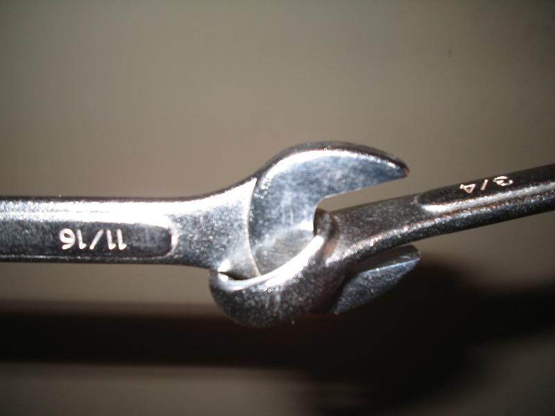

And a closeup on the connection:
