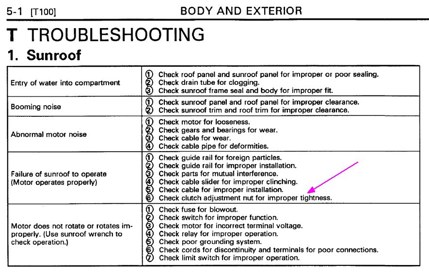

can someone post the page(s) from the manual that show the adjustment of the sunroof clutch nut?

yeah i saw that.
i am looking for the page in the manual... the dealer says it doesnt exist.
and i want them to see it in the manual so that they will adjust it or me.

I have been through the following sections of the FSM
Body and exterior
Interior
Sunroof removal, reinstallation and troubleshooting
Pre-delivery
Periodic maintenance
There is no diagram showing this nut or how it is adjusted. In the sunroof troubleshooting section it only mentions it once.
From the FSM:
