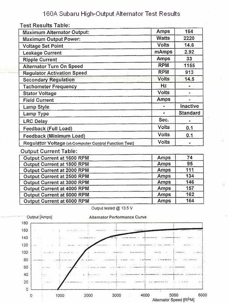

The seller said the alternator was 160A, but kyjoyes said it bench-tested at only 125A. Kjoyes also said his stock 95A alternator tested at 115A. Why wuld one alternator test lower and one higher?

The specs on the 160A high-output alternator that kjoyes bought from eaglehigh look pretty good. I ran them by Christian at Maniac Electric and she agrees.
The only question is the stability and durability of the voltage regulator they use. Since the alternator rpm is 3 times the engine rpm, the real time stats are:
At 600 rpm idle, alternator is producing 95A
At 2000 rpm, the alternator is producing 164A
Our 750rpm idle should produce 115-120A
I believe they want $200, plus shipping for a rebuilt unit. If you have a core to send them at your expense, you may be able to get it for $150.00, plus shipping.
Just a temporary option if you need an alternator before Christian can start delivering again.
