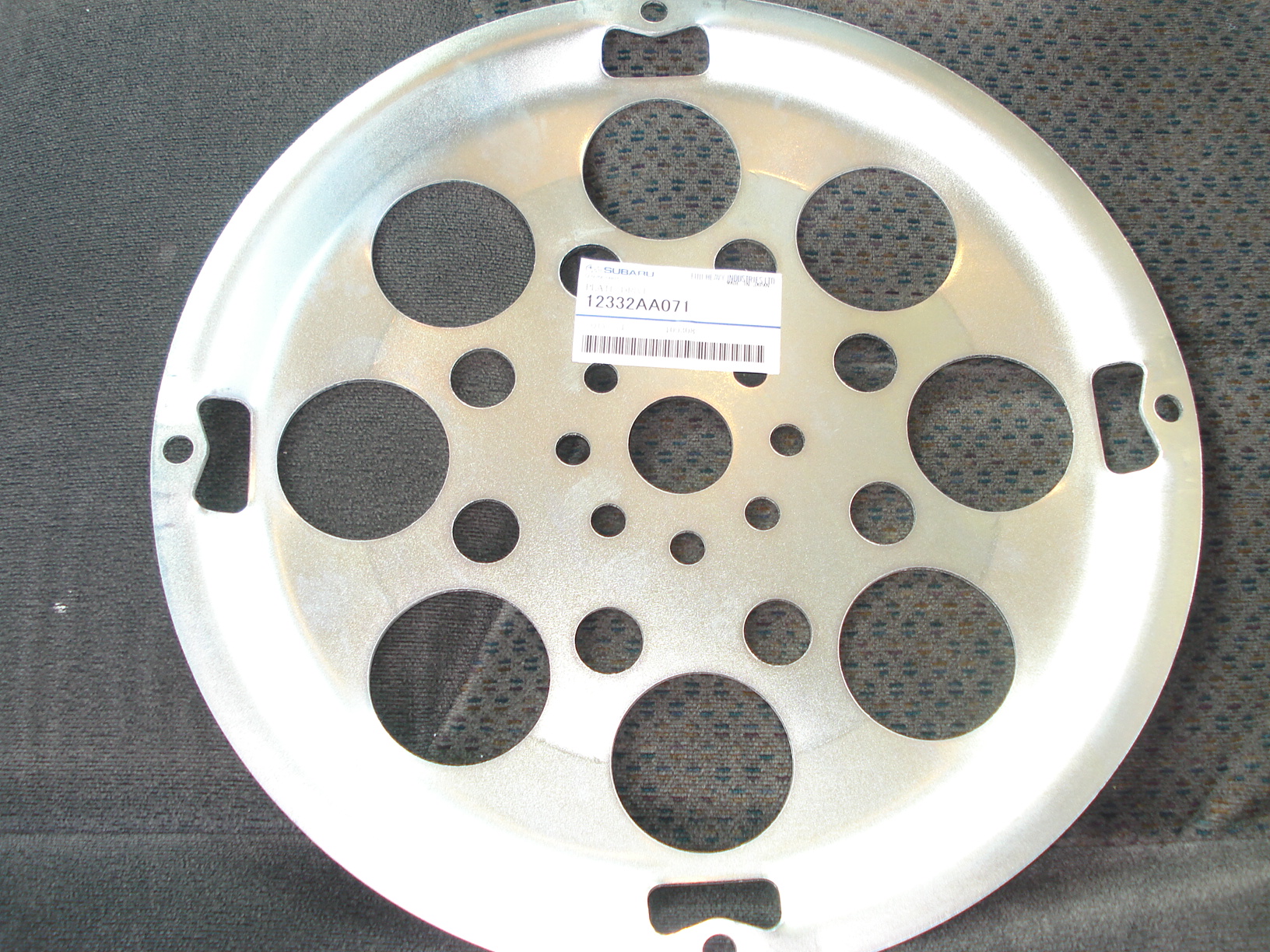

Here are photos of the 2003 Outback flexplate for our SVX, with the part number.
Old 06-04-2011, 12:22 PM
Re: Flexplate part number?
The pic he showed is a later flexplate. The stock phase 1 flexplate has just 4 large holes but is thinner than this one.
