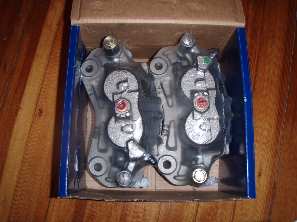

Originally Posted by svxash View Post
I just checked those out and noticed the front has ceramic and the rears come with semi-metallic. Is the caliper made by Morse or Fenco?
Mine were Morse. I took some pics...
Ebony/Gray '92 LS-L, @123k - bought 01/17/2010, parked for 10 years. Getting back on the road.
