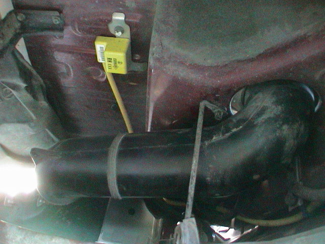

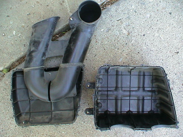

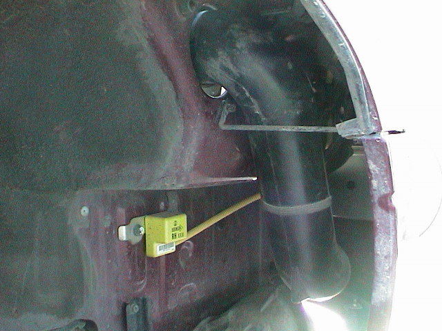

I removed the intake resonator on my wife's car. It seems to help a little. I didn't notice much of a change in the sound. I didn't cut the tube in half I just cut along the two tabs that held the two tubes together. That way if I ever want to put it back together I can. Here are some photos.
