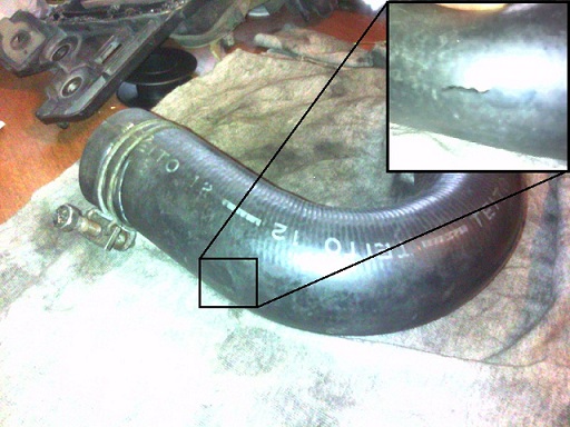

Found and replaced this. Noticed it start leaking two days ago and got really worried because a lot of cooland was pooled under the intake. But as soon as I had time today, I let it warm up until the thermostat opened and it was easy to spot spraying out of this crack in the upper rad hose. Fortunately, I had a spare. Took all of ten minutes.

You should check out the lower hose as well.

Good thing you found it...mine split and i didn't notice. Ended up finding out at a gas station when the car looked like it had just huffed 20 cigarettes.
