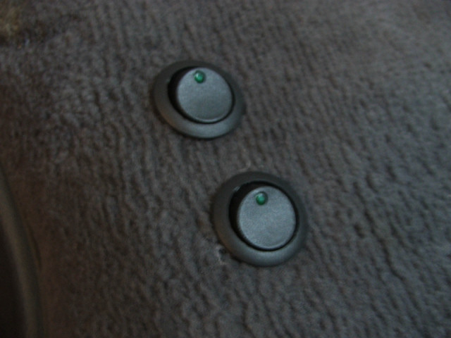

I got tired of messing with the blue wire to access the engine codes. So I installed a pull switch so I can easily check the codes without removing the kick panel.
Great minds think alike- I just finished this up last night:
top switch only does the memory read, top and bottom buttons will clear the code.
Great idea! Good work.

I was also thinking about 2 switches, but I did a quick install with a switch I had laying around. WOW! Nice clean job!
ALl you did was run one wire from the switch, to that spot?
Wire the blue wire to one contact and a wire into the pin for the other contact for the switct. Connects the circuit so you can check codes.
Ah okay..Might want to do this with you and Subix if we get the chance when I come to Indy.
Brilliant! I'm going to do that too now.
