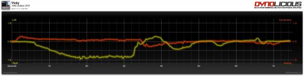

I had some skidpad fun using my iPhone and Dynolicious software. Around a 300ft skidpad the car hit .96 lateral G.
Test conditions: (this was an impromptu thing, so hardly ideal setup)
Temperature: 7* C (45* F)
Coilovers: Full soft.
Ride height: low.
Tires: General Exclaim UHP, 40 PSI front, 35 PSI rear.
Car load: 1/3 tank gas, myself (165 lbs) and 145 lb passenger.
Observations:
I was told the car cornered very flat from people watching, it certainly felt like it. There was some rubbing in the front outside wheel well, but nothing extreme. The parking lot we used was quite bumpy, as you can see in the graph from all the jumpyness of the line. The main limiting factor at this point is my tires. The Exclaims were fine with soft stock suspension, but can't handle the extra demands of the coilovers, the sidewalls are just to soft. They were my first set of "performance" tires and my initial thoughts were good, however now that I've had them for a while and have more varied experience with tires I would certainly not classify them as "Ultra High Performance" as General claims. Rather I would call them an aggressive touring tire.

Is that with the car still slammed? All told, a skidpad queen is nifty until you get into turns that will throw your camber out the window and make performance mods cost performance!
  #53
Old 11-16-2010, 05:16 PM
Re: STI Suspension Swap Project
Yep, still slammed. I know, I know. The car hasn't even been on the alignment rack since I put the coils on. When I did the alignment this summer the specs were on factory all around, which are very conservative. Not even a full degree negative on camber and zero toe all around. I haven't bothered because I've only put about 60 miles on the car since then and it's about to go to bed for the winter.
Right now I'm just having fun with this coilover thing. I doubt I'll be bringing the car to a track for a while, but when I do it'll be at proper ride height, aligned, balanced, etc. What are you running for alignment specs Rob? The local Subie guys go for -2* camber all around and zero toe.

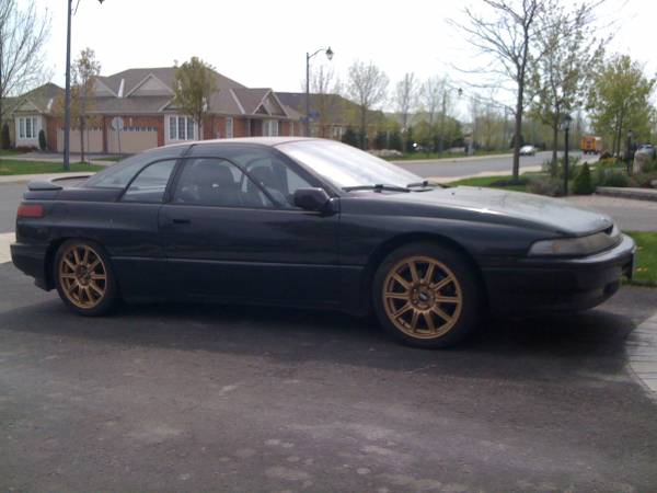

Just a fun little bit of info: I had to raise the front of the car to get it onto the U-Haul trailer that brought it home the other week (1200 miles in a POS U-Haul cube van does not make for happy Chris). There's still adjustment left, I didn't try to max it out, but this is how high she's currently sitting:
I haven't touched the rear, didn't need to adjust anything to fit the trailer. Raising the front was about 20 minutes work with hand tools and a floor jack. Amusingly, I had to drive the front wheels onto 2X4's AND remove the gripper thing from the jack to get it under the side of the car.
