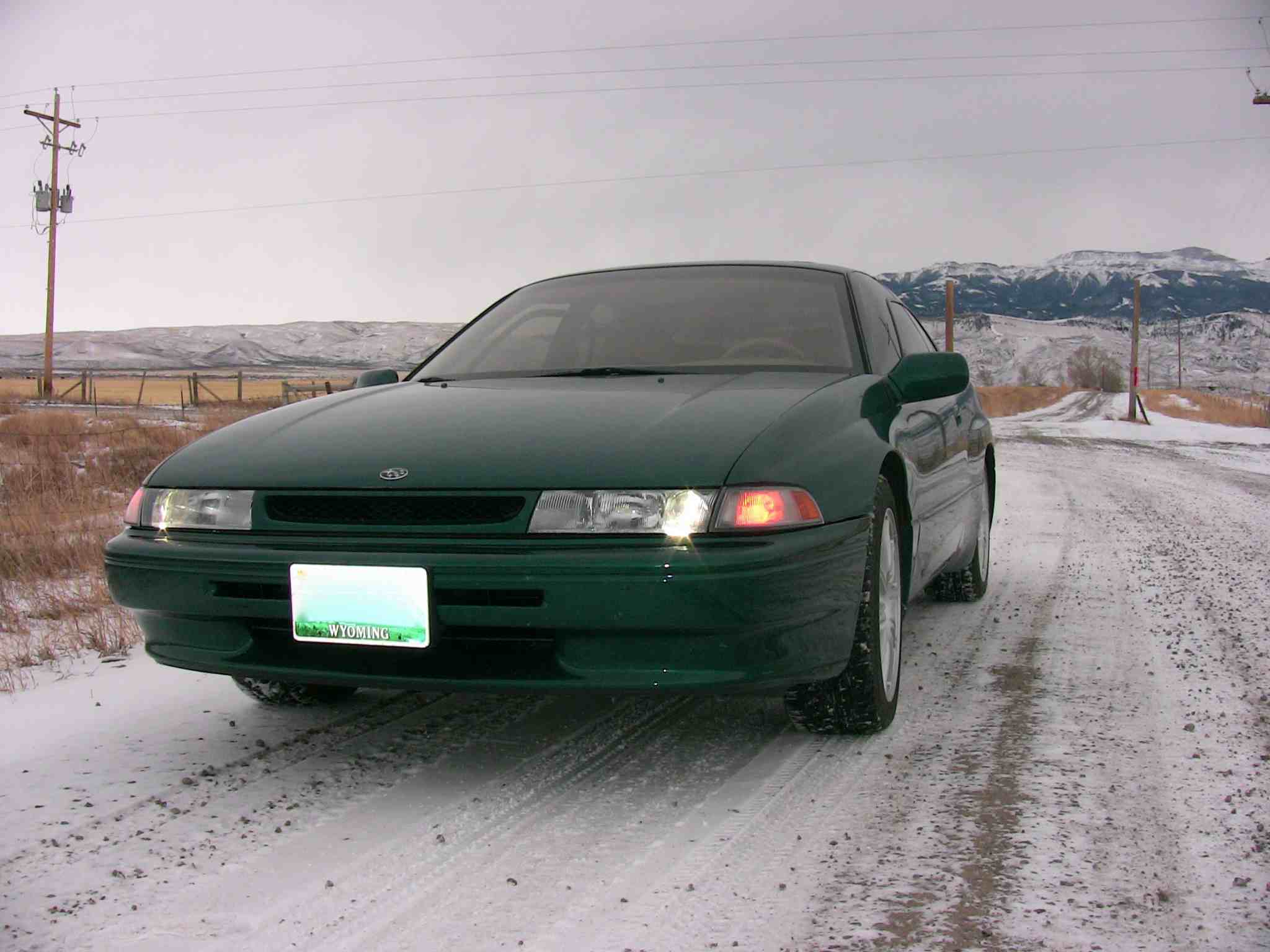

Had an interruption in my install of these lights but finished them today, for now. Halos later, after I think about how I want to wire them a bit. I want them as daytime running lights but not sure if I want them to always be on or switched. They're installed but not powered.
Anyway, Will at Prolightz was easy to deal with, did the work promptly, and the workmanship is better than factory. He was even helpful after the install when I had questions.
The install was very easy, just took a little time. If anyone wants, I can send pics of what I did but you can also find them already posted where I was whining about a suspected short ("fusible link".)
As most know, if you do this, make sure your wiring is clean. My battery terminals weren't clean enough and that gave me fits until I did the simple job of properly cleaning the terminals.
