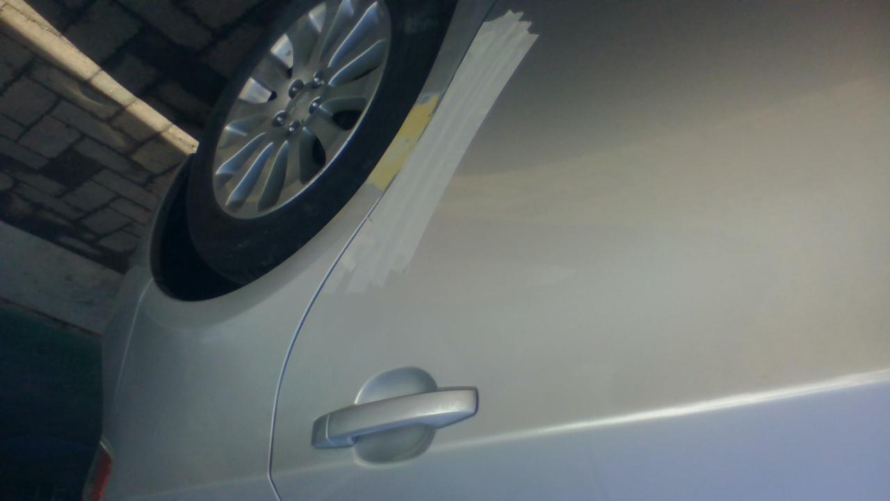

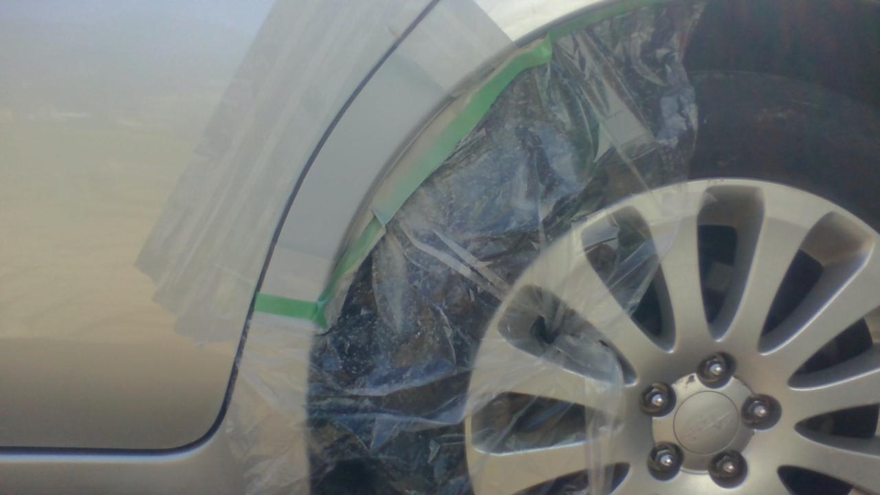

Today, I'm replacing the rear door of my neighbor's Impreza. It seems that the wife has rubbed something from front to back somewhere.
I managed to find the rear doors in the same color for now, but am still looking for the fenders and front doors.
The body was probably torn apart when it came into contact with a guard wire or something. The rear wheel arch cannot be replaced, so I repaired it. This time, I used sheet metal solder instead of welding because the area is small.
It will take whole day today to apply a few coats of primer and then paint.
Today is a warm day with no wind, so I think I'll be able to complete it.
I also painted the spare seat belt anchor parts that had turned white.

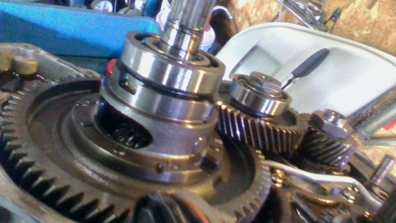

Today, I opened the transmission of an R1 that has run 230,000 km. The R1's transmission was making a strange noise from the front differential, so I replaced it with a used one when I replaced the engine.
I have overhauled the rear differential many times, but this is the first time I have done the front one. The CVT is a type of AT with a complex hydraulic circuit, and even small particles can cause problems.
To be honest I'm not confident I can repair this transmission.
Anyway, I wanted to find out what was causing the noise.
The pinion gear is in heel contact. The bearings are so worn that there is a large gap in both the axial and thrust directions.
Replacing the bearings might fix it, but if the gears themselves are worn out it might not. If you have to incur the cost of replacing the gears, you're better off just throwing it away, as used transmissions are cheaper.

I asked the dealer and they told me that the pinion gear was already NLA. I have already purchased the bearings and seals, so I will try to replace them when I have time.
So if it doesn't get fixed I'll throw it away.

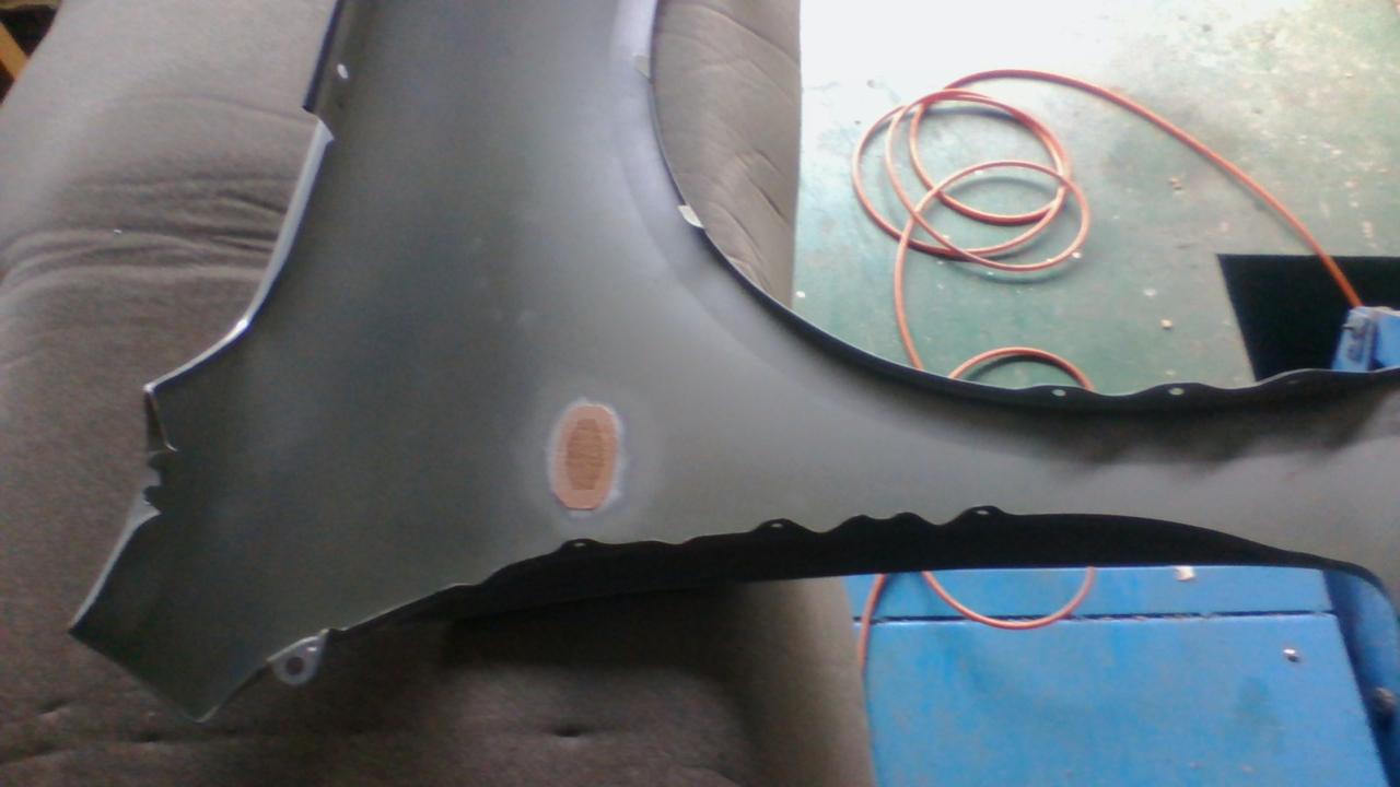

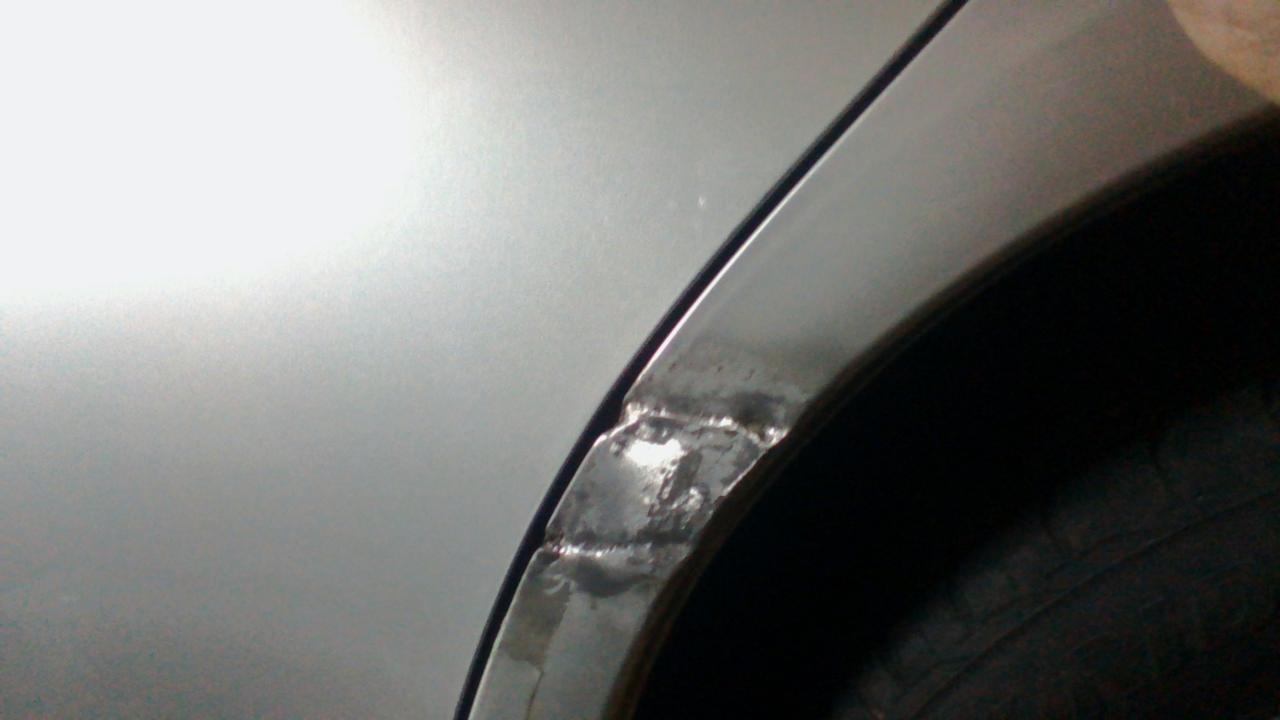

I got a used fender (wing) for my neighbor, but it has holes for turn signals. His Impreza has turn signals on the door mirrors, so he doesn't need turn signals on the fender.
I had no choice but to seal the hole. Since welding could warp the thin steel plate, I used sheet metal solder again this time.
My wife's friend had previously damaged a bumper in an accident and replaced it to used one before. I had it repaired partway before. So I applied putty that too. I think the shape was restored nicely.
To be precise, the husband of my wife's friend borrowed her car and had an accident. He left it for over three years without repairing it, and she seemed very sad. It's a terrible story.
Anyway, ABS and PP bumpers can be repaired by heating them.
