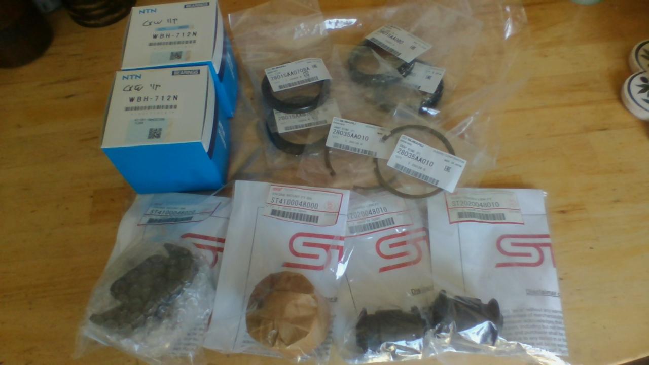

Today I drove my R1 to the SUBARU dealer to receive ordered parts. The R1 is running fine, and when I put gas in it, the fuel economy was about 15km/l, which is normal. No particular abnormalities were observed.
I got the rear wheel bearing seal and snap ring for SVX, and the engine and transmission mount for VIVIO. The original engine mount was NLA, but STi had a compatible part. The rubber is a little bit hard, but it will be usable. I was also lucky to be able to buy the lower arm bushings.

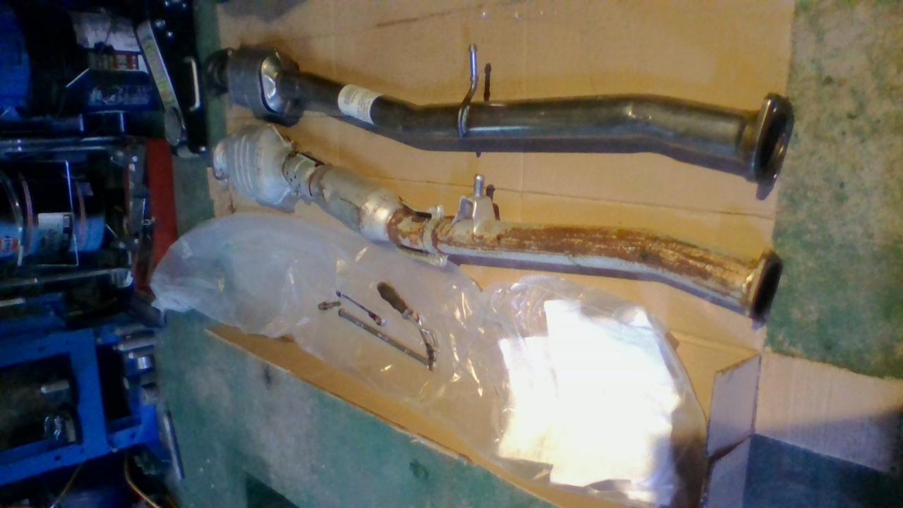

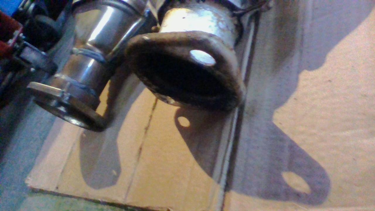

I received a sub-catalytic converter (intermediate pipe) for the Impreza from the UK, so I tried attach. The general shape is correct, but there are some differences from the original. The hook for the rubber ring is too thin. This is not a big problem.
The problem was with the connection to the front pipe. The thickness of the flange metal fittings was much thicker than the OEM ones, the shape was bit different, and the original bolts with spring is too short enough for this.
The exhaust vibrates so it is very important to hold it down with a spring.
And .., There is a slight exhaust leak. It's not enough to pass the car inspection. Some modification is required. Well, that's what I get with British products. I have a lot of similar experience with MINIs.
I'm still busy so I'll think about what to do later. I'll just think myself lucky to be able to buy a new, not rust exhaust.

For the Impreza exhaust, I decided to get a used junk one and transplant the flange from it. It just $10 and It will certain fit
I'll buy a new pipe to fix the rusted out OEM exhaust when I have time. Welding is easy, but to make it exactly the same, you need something to hold it in the same position. We call it a jig.
