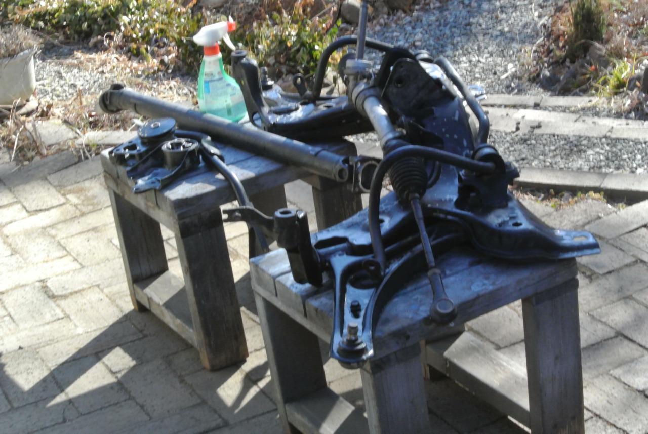

Today is day 3 of engine swap.
Because the work space was small, the removed engine was moved to the rear of the vehicle. The rebuilt engine was placed on a table lifter.
The subframe, stabilizer, and other parts that will be reused were washed outside to remove oil stains. They are planned to be repainted just to be safe.
Tomorrow I'll paint and clean the engine room. It'll take a long time, but I don't get a chance to clean the engine room very often, so I can't skip this task.
There is oil seepage around the exhaust valve No. 4. When the engine was not started for a few days, white smoke came out, probably due to the valve stem oil seal. This engine will be overhauled later.
his engine has been used for 240,000 km. Other than a small amount of white smoke coming from the muffler and a slight loss in power, there are no other problems, so I think it can still be used if the piston rings, metal, and oil seals are replaced.

Today I repainted the subframe and various other parts.
There was no time to clean the engine bay.
