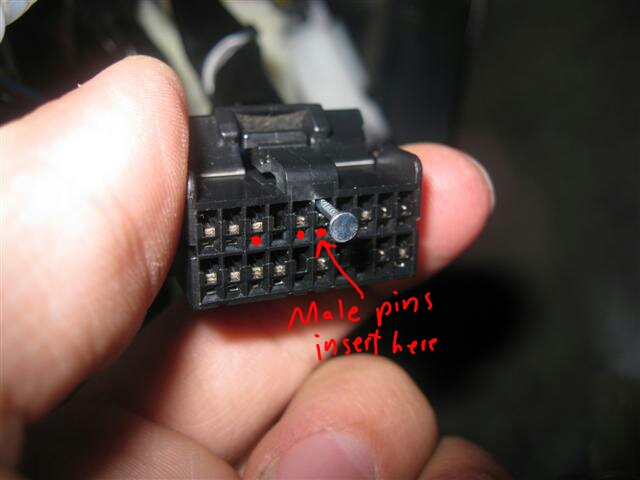

http://delphi.com/connectors/assets/...ure/met150.pdf
This is what i think we're looking at...release tab on opposite side.

I believe you are correct, however I think the male pins from the mating connector insert in the red dots shown below. Which would mean that the release tab that is "opposite" would be where the nail is, is that correct?
It has been a few years since I did this mod...

It's my belief that the red dots are where the tool is supposed to slide in to depress the tab. I won't know for sure until someone shows me the female connector. It's my experience that the lock tab is on the opposite side of where the terminal "teeth" bend around and bite into the wire.

Does ANYONE have a photo of this released terminal? I've tried this in every slot down the row and it's worked on none of them. 2 jewelers screwdrivers, 1 safety pin, 1 finishing nail and 1 long male spade......zilch.

If i can see the actual connector on the end of the brown and black wire,,i can see which way to release it.
