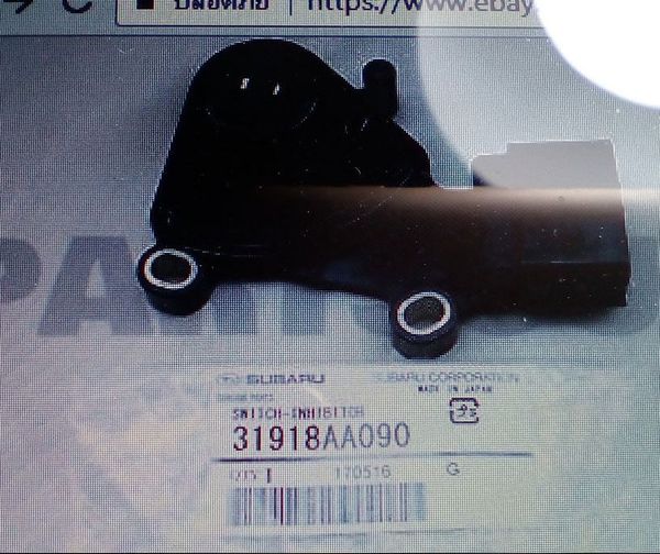

I just found an inhibitor switch on ebay for 82NZD, including postage.
Part no. 31918AA090
It’s for Subaru WRX, 2008 and up.
Anyone know if this part no. can be used in SVX?
(I asked the Subaru dealer in NZ once years ago) They quoted me 300NZD from Japan.
Recon if its only 82NZD. might as well replaced DIY) solved
