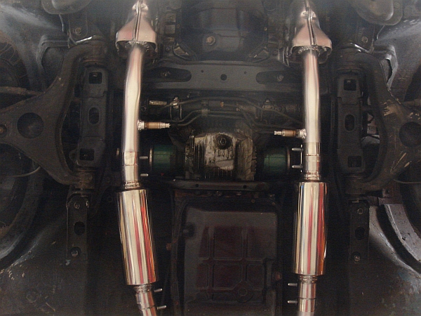

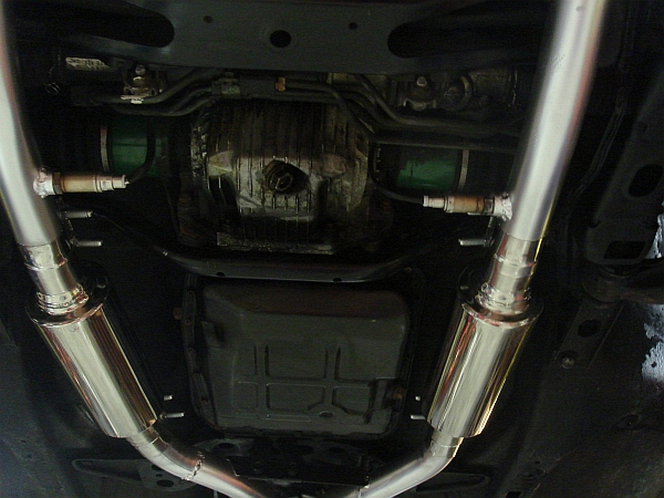

Re: '97 left pre-CAT pipe
Same here. Just made 2" headpipes with new flanges that went into 2" inlet resonators (and later 2" inlet pre-cats) welded in bungs for the O2 sensors and good to go

Nice job svxcess!
