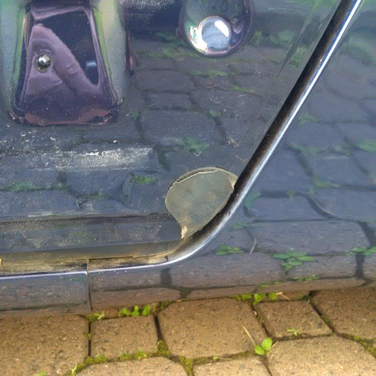

Took my driver's side door garnish off to figure out why it isn't staying in place at the bottom. Door is solid, but the panel has a definite curve to it when off. It flares at both ends.
Any Ideas on how to correct this? I was wondering if some 2 sided tape like 3M 2-way adhesion tape, vertically near the bottom might work to hold it snug. Am going to replace the retainer bar thing at the top that bolts & snaps onto the door.
Is this black stuff supposed to be here? Or is it leftover from a previous paint job hack? It's hard and brittle like plastic. Any idea on how to remove it if it's not supposed to be there?

To answer my own question and let others know; that black blob is panel bond. The shop that painted the car used it as an adhesive to try to hold in the garnish, which was incorrectly installed. It obviously failed. The only way to remove it is to GENTLY heat it and slip something wide behind it to pop it off as it softens. (A plastic putty knife or similar.) Get things too hot and the paint will be damaged.
