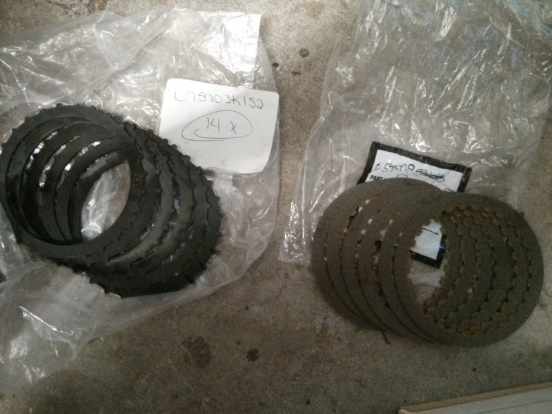

I finally received the parts. The trans shop that ordered them for me were totally dragging their feet. I put all the clutches together last night, everything went together fine and the clearances were ok.
Here are the part numbers of what I ordered. My trans is a mismash of different parts so you'll probably need things different... But it gives you an idea. I did need the 3.4mm high clutch pressure plate, and even still clearance was tight.
(6) Raybestos R573765
(4) Raybestos R573790
(6) Raybestos R573780
(6) Alto 075703K152
(1) Alto 075760-340
(2) Alto 075707-225
(7) Alto 075700A
(2) Alto 075950
(3) Alto 075708
I have attached a pic of the 1.75" brake band (the new one is on the right) and of the Kolene steels and Raybestos green kevlar frictions. The Alto Red Eagle frictions were not available.

I have a few miles on it, and so far so good. The 2/4 band took a bit to break in, but it's a definite improvement. The high clutch is much firmer as well. All the other gears work as expected.
I also installed a new transfer clutch from Subaru (seems it had Kolene steels too, by the looks) and it's a bit grabby. We'll see how it is when it gets more breaking in.
Anyone have opinions on fluid? I am using Valvoline Maxlife DEX/MERC ATF. It's pretty cheap for a synthetic, and the specs are pretty good.

The transfer clutch will need to be broken in. You'll be surprised how long this takes. Did you use the thinner bearing and updated drum in the high clutch? The hub is also slightly different, it seems that they really wanted to increase clearance in the high clutch area and provide for lubrication.

I've been tuning the TCU to fix up the transfer clutch, it's going pretty good. I thought about break-in but it's my understanding that the factory breaks them in. When I bought the new ones from Subaru I could see they were worn already, and they were all in a matched set (already assembled) and covered in fluid. They may need to break in a bit more, we'll see.
I had to use the old style high clutch drum to use the special Kolene 1.52mm steels. With the newer drum I could not get 6 frictions, the tooth pattern is different. The old drum also required the weaker reverse frictions, unfortunately. I think there is some drum that's in-between that takes the Kolene 1.52mm steels and the newer reverse frictions, but I couldn't find one.
I was able to use the smaller bearing thrust plate and newer hub, so that's an improvement.
