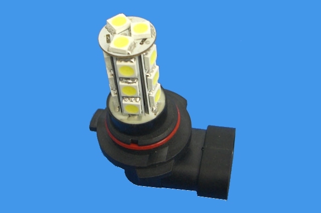

I need to replace my driver's side (will do both sides) low beam and want to upgrade to the 9005 mod. But I want to know if I should stay with the normal HID upgrade or is there a better advantage in useing one of the new LED bulbs. The LED bulbs are cheaper but they come in several configurations and I don't know the advantages/disadvantages. Some are 13LEDS and other can be 18/63/128 SMD. I do know that the LEDs draw less current and suppose to last longer but what about range and brightness/intensity/color? Anyone have any experience/recommendations and what is the difference between LED and SMD except, I assume, size?
I may be wrong, but SMD I believe stands for Silicon-mounted Diode. Basically a light emitting diode mounted on a silicon chip. (shown below... the yellow squares are the SMDs. Silicon chips, with blue-frequency LEDs on them, covered by a yellow phosphor layers and a plastic encapsulating coating. The yellow phosphors excited by the blue light output combine to approximate white light of varying color temperature, depending on the blue intensity, and the number of phosphor layers.
SMDs tend to be brighter versions of light emitting diodes... sort of like a supercharged LED. I don't know much about the actual technology, but I think I remember reading that it is some sort of pulse-modulation amplification so that it pushes more current through the diode than it would normally pass, and that results in more light output.
Someone with more knowledge on the subject might have more accurate information.
The issue not only becomes about lumen output, but focus. halogen reflectors focus on a filament. HID reflectors focus on a sustained electric arc, and some halogen reflectors don't focus correctly on an arc, some do a passable job.
LEDs are in arrays, and there are many individual focus points, each emitting narrow relatively narrower fields of light. a halogen or HID oriented reflector really won't focus properly on them.
I like LEDs as technology, but they are a different animal than a a spherically radiant source like incandescent/halogen, or HID/arc lighting.
LEDs are starting to encroach on Halogen/HID in purpose-built light fixtures that are designed for LED output patterns. But they are different enough that I am not sure that just putting an LED replacement bulb will perform as well, for something as high-output as a headlight. Signals and other lights that are for recognition, rather than projection, are easier to retrofit with effective results.

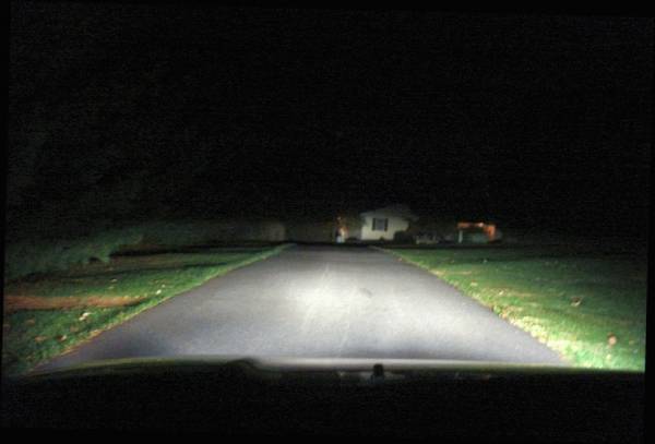

Originally Posted by Jvan View Post
I am somewhat concerned about using true HID because we don't have a self-leveling system in our SVX's and I'd like the light on the ground not for airplane spotting.
I have had the 500K HIDs in my car for over 4 years and have NEVER been flashed by oncoming traffic. I also have HIDs in my foglights and have been flashed only once (Not because I was blinding anyone, but because they saw 4 lights and ASSUMED I had my high beams on.) The light is brighter, but still focused by the projector lens.
In winter, I often drive with just the fog lights alone without problems.
Photo of my HID low beams and fog lights at night:
Look in my locker HERE for more photos.
