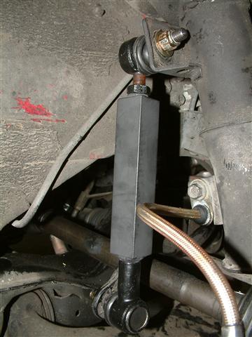

One quick update: I came up on a pair of STi Hotchkis adjustable endlinks and decided to toss together some extensions to make them fit the SVX.
It's certainly not the prettiest job, but it did get rid of the mild front-end clunk I've had since the day I got the car.
Well, not everything shiny is always effective. As long as these are "hidden", who really cares?
Again thumbs up for you for a great custom work.
