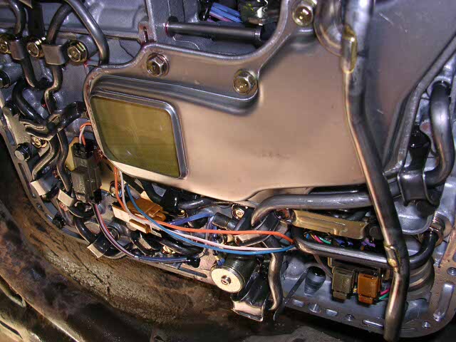

If you have forward and reverse, then the manual valve is connected ok. This is the valve at the top middle of the pic
Is this where the connector is or out side the box?

Yes that is the manual valve, it selects 1st and reverse, but if you have both of these gears, the valve is connected.
The other thing that can prevent it from shifting is no speed sensor signal.
