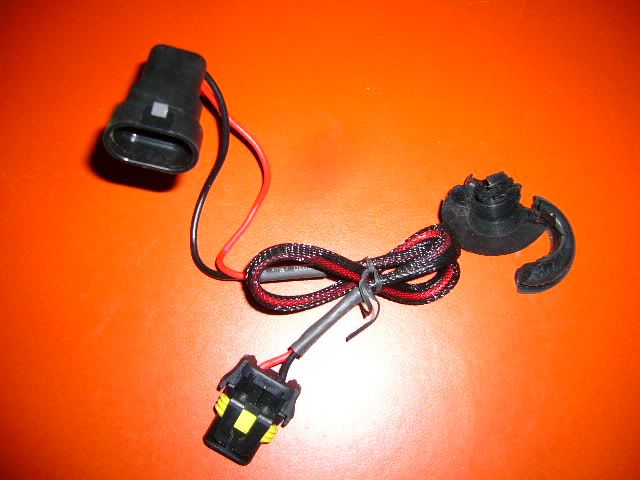

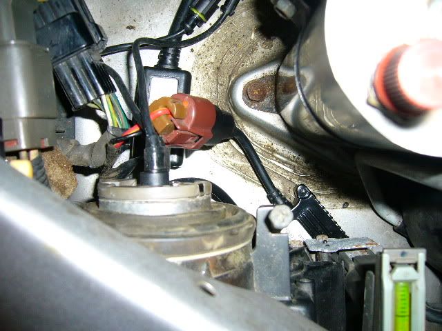

Originally Posted by Ownbot View Post
Anyone got pics of how they mounted their ballasts? I would like to see how others did it.
Hi! I removed the power extension cable and cut off the molded grommet.
The original receptacle"plug" that was connected to the old 9006 bulb can plug directly into the pigtail on the ballast. Pix of unnecessary ext. cable and cut grommet.
When you plug the headlamp wiring into the ballast, you must insert it in upside down, as the SVX is a negative switched system. The "shark fin" retaining tab must be opposite the "doorway" or "keyhole" molded onto the SVX headlamp connector. This works good in this connector, since the opposite side has a c shaped cutout that the tab will fit into without latching, but the fit is tight enough that it shouldn't vibrate out. You may want to put a layer of electric tape around it tightly, for retention.
The slim ballast fit under the headlamp, you can just see the corner of it in this picture, the small igniter module (on the left) fits easily near the a/c dryer can and the extra wiring tucks under the ABS pumps raised mount.
I did not use the factory supplied double side adhesive foam tape, but opted for self adhesive Velcro strips so that:
1. The modules could be easily repositioned +/- 1/2 inch to fine tune location.
2. If/When they fail I can easily swap back to standard headlamp.
Regarding "Lifetime Warranties" , there is no guarantee like the test of time... When a "non-brick and mortar" company is in business <5 yrs. and they offer a warranty >10 years, I have to take a grain of salt with that....
I only have about 2 hr. of usage on my 9006 conversion, and a painless installation, and am a happy camper/pleased. In my experience as a car nut, you get what you pay for, and I wouldn't be surprised if these failed in the next 100 hr.
After you do the passenger side, the right side will be easy.
