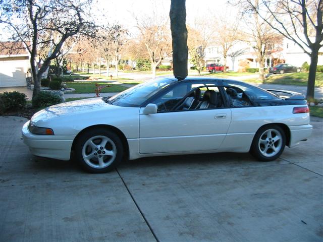

Try searching for Mazda Millenia wheels. Perfect for winters. The narrower tires are better for snow. They cut through rather than ride up on top.
http://www.subaru-svx.net/photos/fil...BABY/21717.JPG
