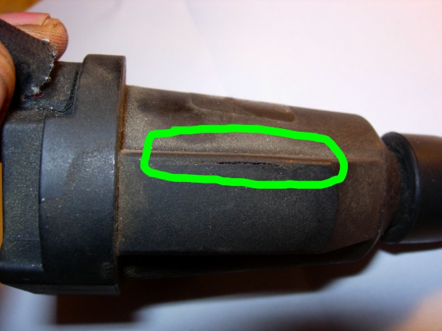

I don't see any burn marks, but there is a crack along the raised part (see pic).
The boot looks fine.
I narrowed it down by pulling the plug on each injector one at a time. The one that didn't make a difference is the one that I'm assuming has a bad coil. But like I said before, it could also be the injector somehow. I'm planning to listen to the injectors tomorrow and see if they all make clicking noises.
I don't have a CEL, but I didn't check for hidden codes either.
Thanks for the help!

My bad coil looked just like that. You could hear it clicking (shorting to the engine from the crack). Try switching the coil with another and see if the problem follows.

Ok, swapped it with the center coil on the driver side and the problem followed. Just ordered a new one now. Thanks for the coupon!
