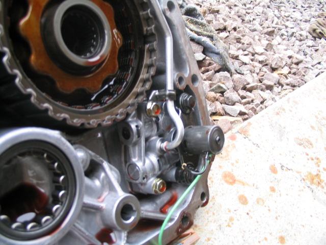

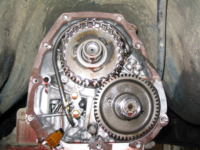

Remove the (11) 12mm bolts holding the tailshaft onto the transmission body and carefully pry the tailshaft away from the transmission body. Once removed, disconnect the single-wire connector to the Solenoid C. At this point, a shaft, a spring and a parking pawl might fall out to the ground. See picture for detail.

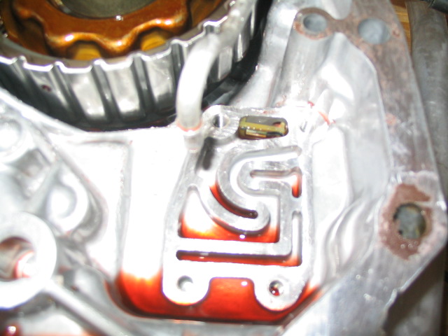

Take the tailshaft to a clean workbench and remove the (4) 10mm bolts -- the (2) black going through the Solenoid and valve and the (2) gold going through the valve only.
Remove Solenoid and valve and separator plate (the gold colored separator plate goes between the valve and the tailshaft housing.)
Clean away all gasket material on the separator plate, tailshaft housing and transmission body and carefully reassemble using the new gasket.
