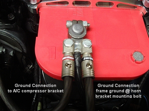

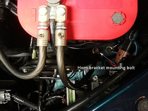

Just as a clarification... two new grounds...
That is from the chassis to battery, and engine to battery, right?
Can it be accomplished by a grounding strap and a large-gauge negative battery lead, both anchored to the chassis at the horn bracket, just in front of the battery?
Or should the engine grounding strap, and chassis ground both need to terminate at the negative battery post clamp? Does it make an electrical difference?

Personal preference.
i prefer having the 4 gauge grounding cable going from the battery directly to the chassis (horn bracket is fine) AND the same type of cable from the negative battery to the engine (A/C bracket is fine)
Electrically, I like the high strand copper wire better than the steel grounding straps. Less resistance.
