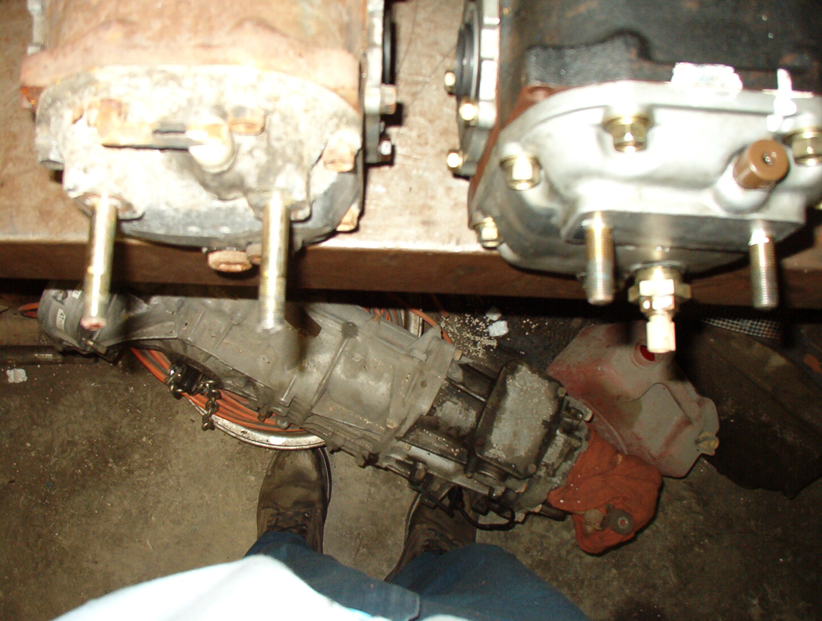

You have to change the studs in the back to the longer SVX ones.

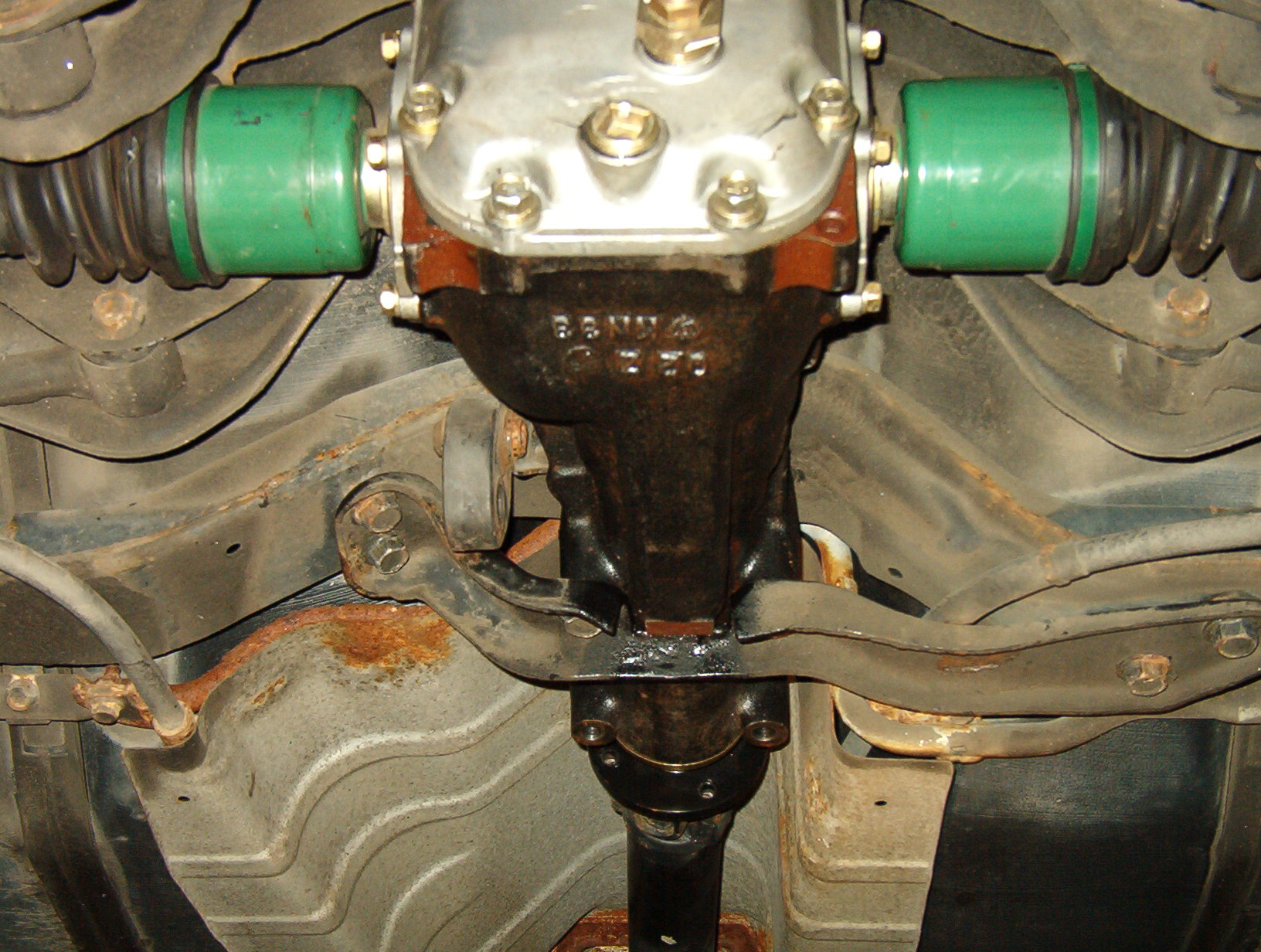

The installed R-180 rear with alxes and modified bracket.
Everything fits pretty good, but one thing I didn't count on was the driveshaft flange having a bigger bolt pattern. I have to take it off and have it drilled to bolt to the SVX driveshaft flange.

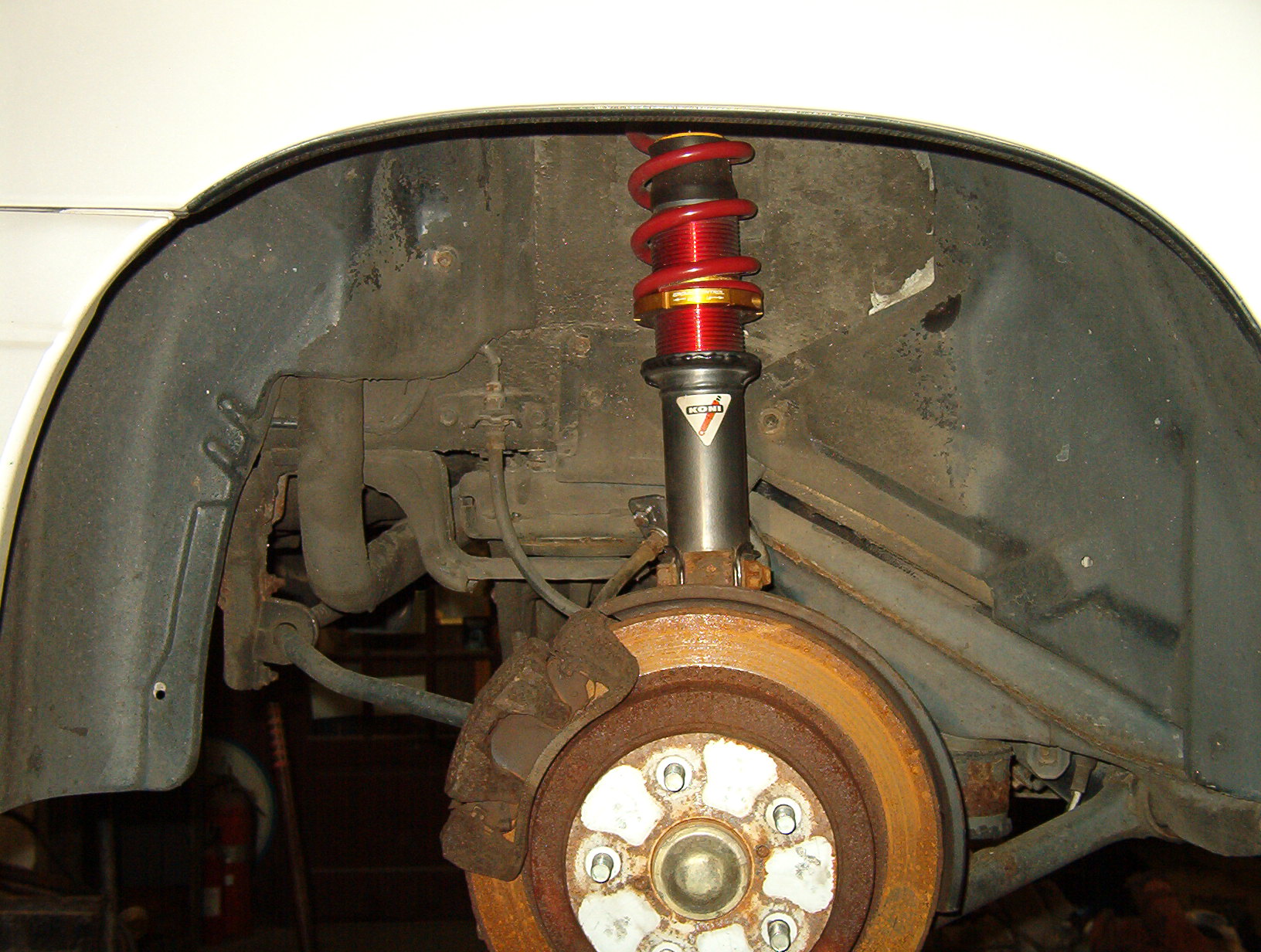

And one more pic just becouse. I had the wheel off and I didn't have any pics of them yet.
Ignore the rusty rotor, remember the car hasn't been driven in three months.

Jesse,
What gears are in the R-180 rear? Is it a LSD rear, or do you have to swap in the SVX LSD

As far as I know all the STI 6 speeds are 3.90's so are the rears. The rear is an LSD as I would imagine all R-180's would be. You don't have to swap out the carriers becouse you can just use the STI axles to. You can see in the axle pics the difference in the STI axle compared to the SVX axle. The SVX axles are the only ones I've seen that use the funny little extended shaft nub on one axle to work in the LSD rear.
