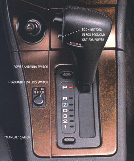

The switch enables you to keep power mode on all the time - even when you're not "mashing the gas". This makes the car much more responsive and gives it a sportier feel.
Nomake, I'll check tonight whether the pins I removed from the stereo plug when I made my SSM interface, will click into the empty space on the TCU plug. If they do then I'll send you a couple, since I have no need of them.
The JDM power switch is at the back of the gearlever. As far as I remember is just uses one of the grounds nearby.
Wait what that button is it?
http://www.subaru-svx.net/photopost/data/538/1571.jpg
What happens if you chip it? Then its even quicker or what?

The photo you linked is a photo of the shifter of a German SVX, not a Japanese SVX. That's why you can't find the Power switch (notice also that the shifter is LHD, not RHD).
If you ground pin A4 on your USDM SVX--as has been said in here--then you'll get a snappier throttle response. Or to be more precise, a more responsive transmission. It's a little hard to explain... the best way is to just try it out yourself and see.
