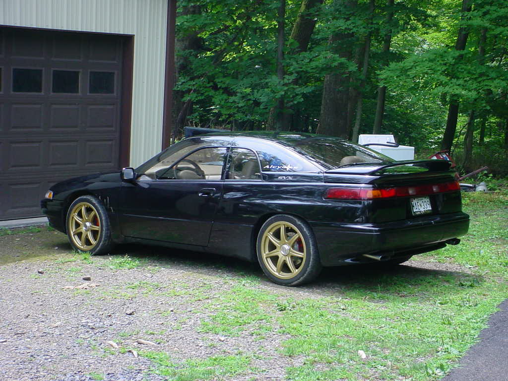

I have 18" Axis Se7ens with 255-50-18" Pirelli P-Zero Systems on my SVX and have never had any promlems, but I wouldnt go any bigger then 18". My tires are thin enough now, I couldnt imagine hitting a pot hole rollin on a set of 20s. I noticed a big drop in exceleration but could care less cuse they look so Damn good. They fill the wheel wells perfectly I think. I got comments all the time that my car is lowered, but its not.

Almost forgot
Brand: Axis
model: Se7en
Size: 18" - 8"
Offset: +38
Price: $800.00 ebay 2 years ago without tires.
Tires: Pirelli P-Zero Systems 255-50-18
im looking at the exact same rims, in 19" 8.0 with the maxxis rear lip
yours looks flat with no dish ? unlike this pic
