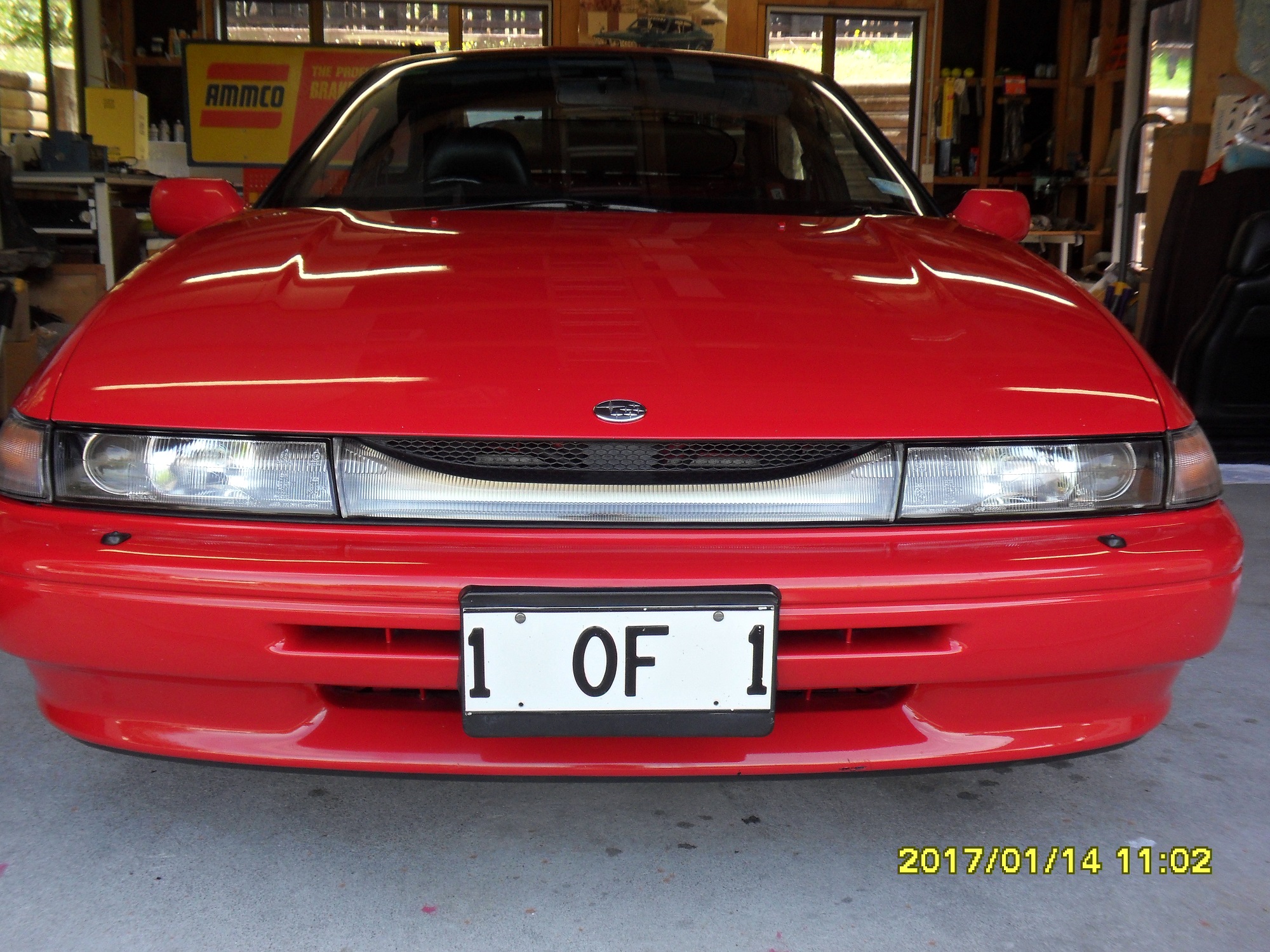

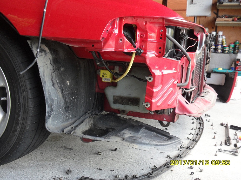

Mine is wired to the headlights (like OEMs) - such that lights have to be on, in order that the washer motor works (no use washing the headlights when you are not even using them!!!).

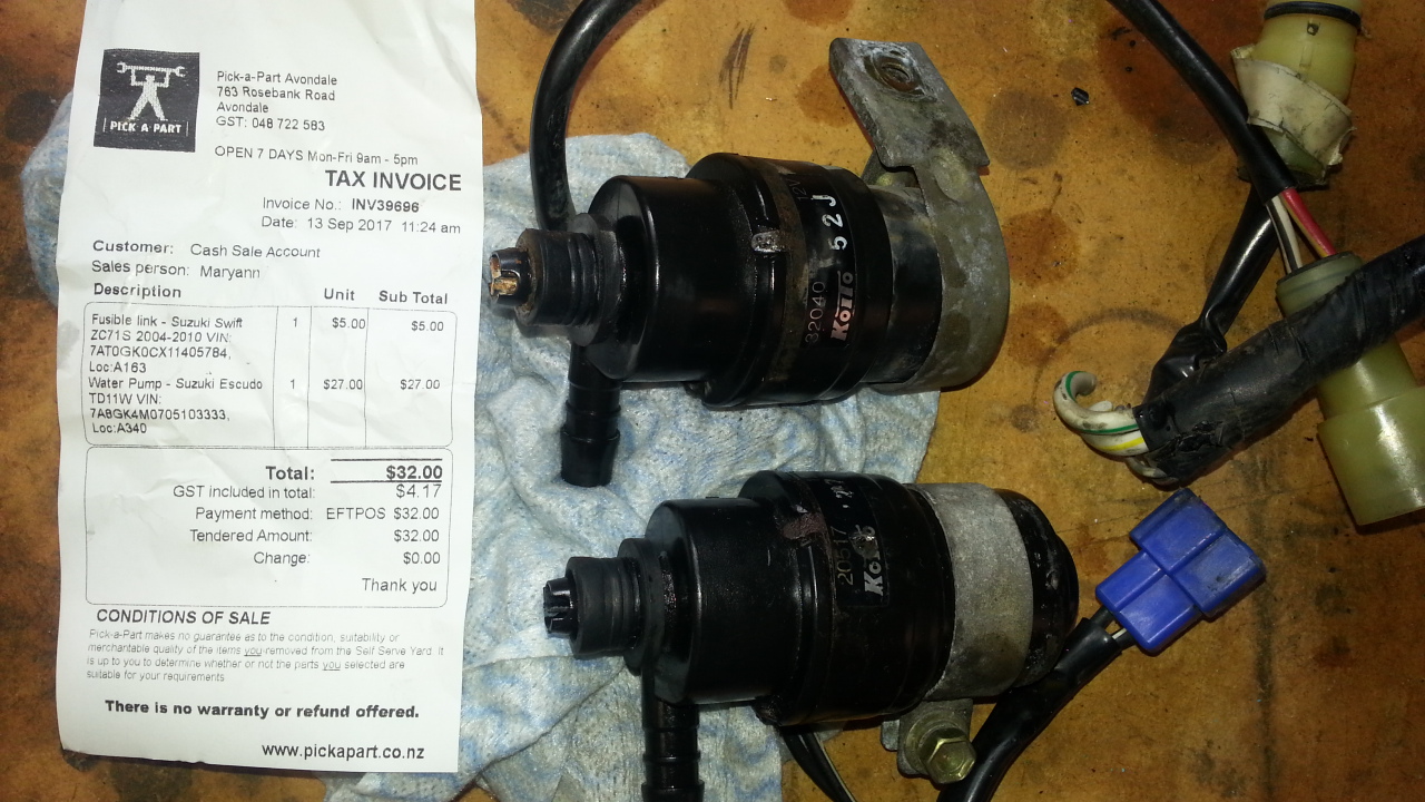

Electric pump is the same as the Suzuki Vitara or Suzuki Escudo (and about 10% of the SVX price!!) - see last attachment, just need to change the connector.
Since doing the addition of the headlight washer in 2017, my pump has died due to water getting past the seals into the pump/motor magnet area - I would suggest that anyone with the headlight washer they should rotate the motor/pump such that the impeller and hoses are at the lower end of the assembly - nearest the ground (I will be doing that with my replacement Suzuki version).
