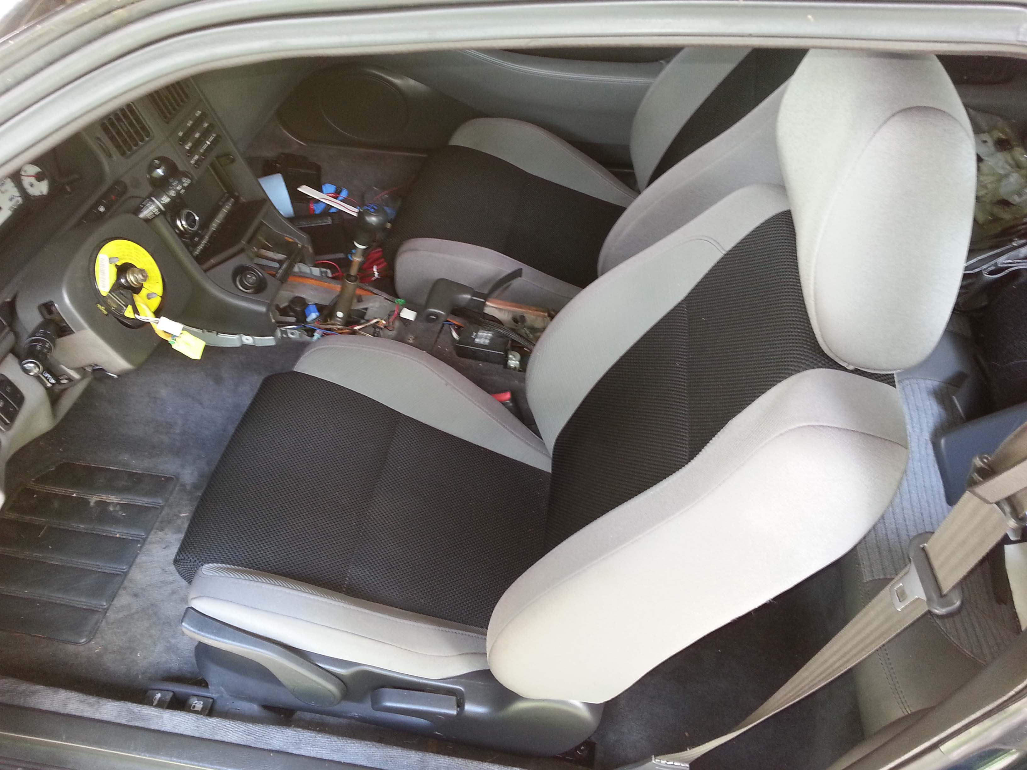

Finished installation of the black and grey cloth 05 Impreza front seats. Problems encountered and corrected: front mounting points about 1/2 to 3/4" further apart in the Impreza - new front and rear seat mounts fabricated from 1/8" steel bar (passenger side rears need lifting to clear outboard rail hitting the ABS controller- could have moved ABS box inboard we think), Impreza seat belt receiver slot too narrow for SVX belts (stole seat side receivers from old SVX seats). Slap the forehead issue - get seats from a two door car as 4 door cars seats do not tilt far enough forward to allow access to the rear seat - gonna live with it as we will not carry more than one passenger in this car.

by request a photo of the Impreza front seats

Nice. Will the rear seat fit? What is with all the other mods ?

Rear seat will require fabric stain/paint to go to black fabric next summer. Console is out to run audio / car pc cable to the trunk spare tire well where we have placed the amp, car battery, and eventually the car PC. Steering wheel is off to trial fit a three spoke STI wheel.

Looks good.
