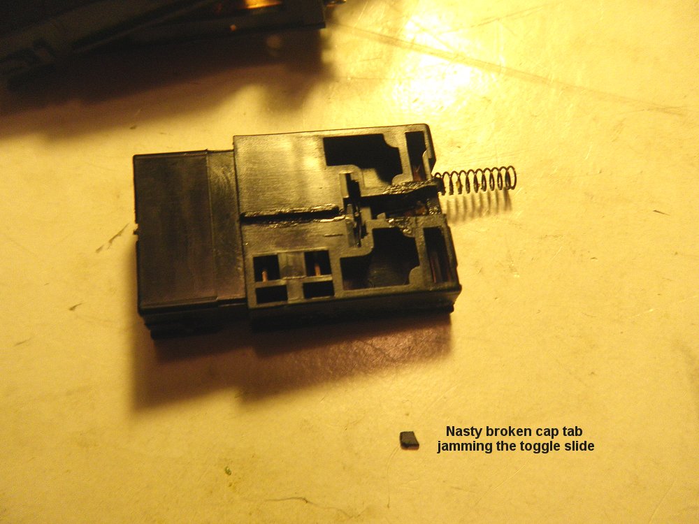

Couple of things this week.
Last weekend the car alarm started acting up, going off on its own - was a loose wire on the trunk latch switch.
Monday took the black graphite 17" 6-spoke summer wheels to the Powdercoat guy for a fresh coat of baked Liguid Silver...'cause black on black over black is just too 'Batman wannabe' for this old Davy.
On the way home the 4-way flasher button jammed at the halfway position, making the flashers impossible to turn off when the car is switched off but worse,disabling the turn signals.

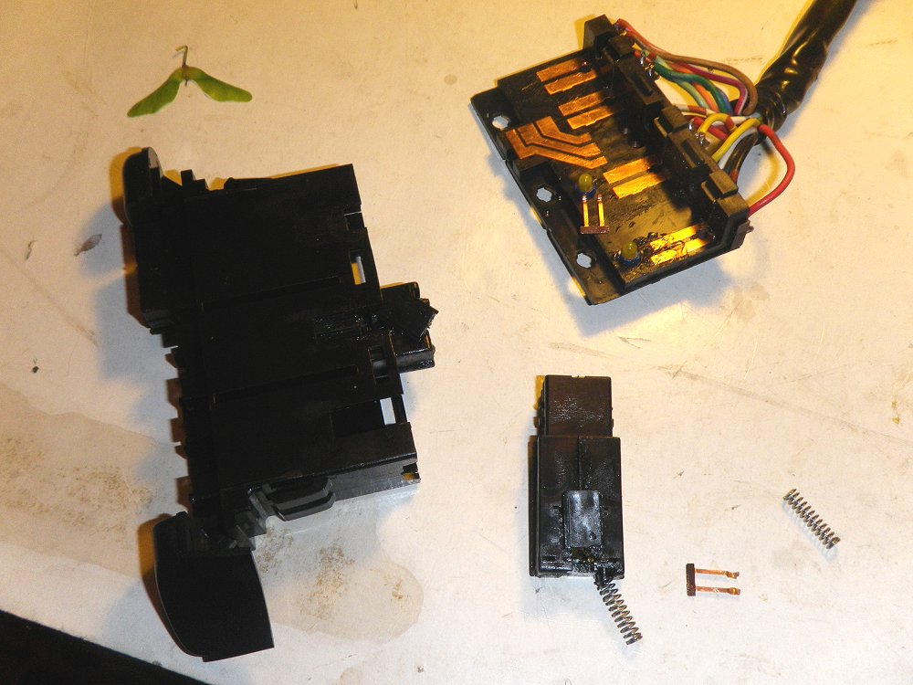

Deductive reasoning and taking apart a spare switch pod showed me how to take the switch apart without breaking it.
Four penknife blades under the catch tabs and you can slide the circuitboard out. The only thing keeping all those contact feelers and springs in place is the factory grease - you've been warned. Also first remove the bulbs.
Problem turned out be to a teensy less than 1/16" square piece of switch cap tab broken off migrated up the side of the sliding element and back to the rear toggle spring channel where it fouled the toggle action.
Had to fix this switch in order to drive the car without hand signals. The spare switch pod is for a non-seat heater SVX so a swap was not an option.
Anyway, put it all back together and Eureka! Turn signals and flashers working as they should.

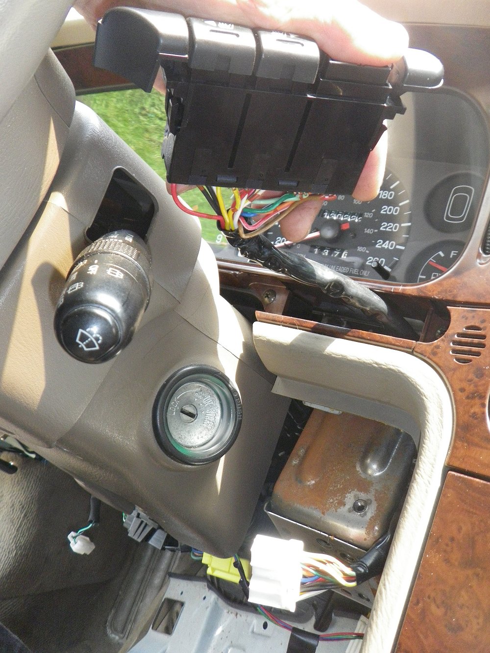

Biggest problem was getting to the pod harness connector to be able to work on it on the workbench. Every other SVX I've played with you pull the pod and the harness snakes out enough to disconnect.
My 97 has the connector factory riveted to the steel beam under the steering wheel. The harness snakes down a slim space next to the radio and back over to the connector plug.
Had to remove the dash cover and metal under panel to disconnect and pull the harness out. Now I know.

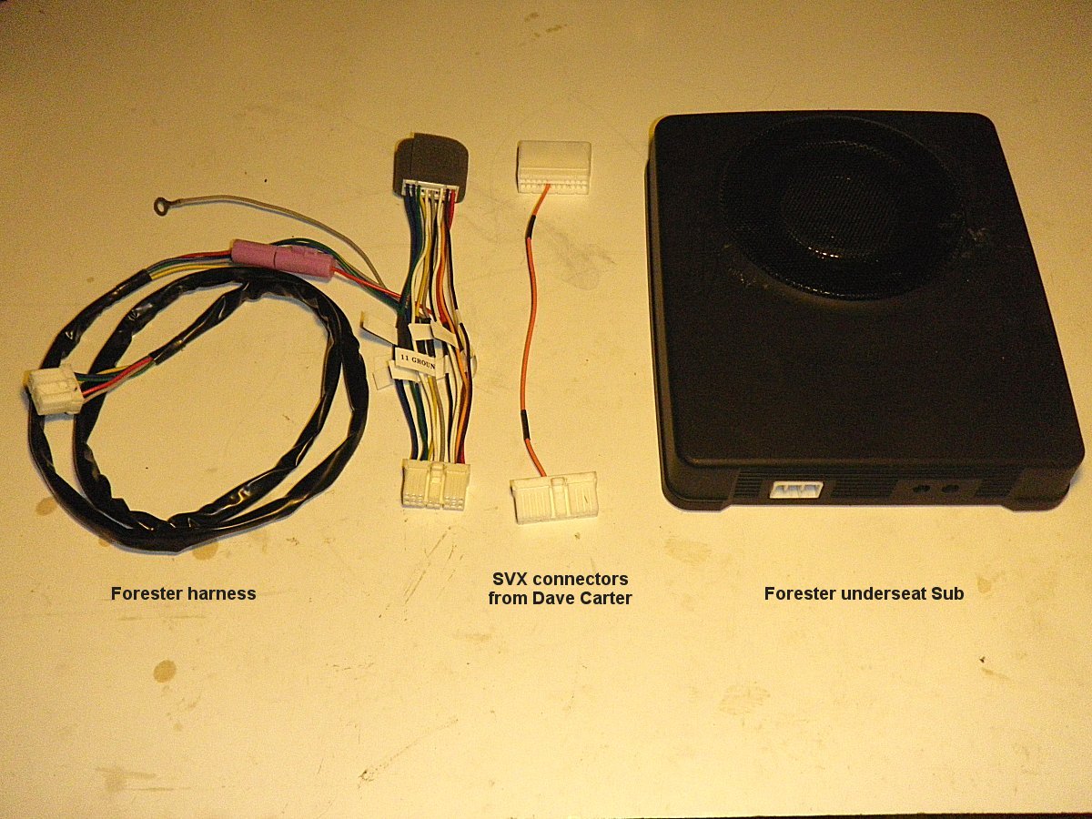

Do you happen to have any photos of the wiring and how the sub is mounted? I've been thinking about doing a setup like that for a while, it just seems as if no one else was brave enough to install the Subaru subwoofer until now

It's a straight forward procedure, Reberto, whether you have an original OEM or an aftermarket stereo installed. I chose to stay with the original radio - sounds spectacular enough to me.
The tricky part is modifying the Sub's wiring harness connectors. The SVX uses unique 20-pin connectors unlike and incompatible with other Subaru models, in which the same subwoofer is a simple plug & play. The sub harness carries all the same electric wires for front speaker signals, power, power antenna, and three three illumination wires, although in different pin positions.
Now, some folks have been in a hurry and just cut & splice but there is a member down in Texas that has SVX specific connectors that can eliminate such butchering. Well worth researching his posts and website for all the options. There's not any room behind the radio for a tangled blob of excess wiring because the back of the cage butts up against the HVAC ducting, so I chose to adapt the sub's harness to SVX plugs. Only adds a 10" bridge harness behind (which can be tucked inside the back of the cage or routed down below the radio. The cable to the sub underseat is a 50" long run down inside the console then down under the carpet at the seat's rear rail over to the sub.
There is a seat heater connector under the seat that gets in the way but like the driver seat, I removed the rear bolts and raised the seat rails 1/2" to get the clearance. Seats are awfully low in the SVX for a short 5'6" guy like me anyway...
David Carter has full information on pin assignments as well as a comprehensive How-To to extract the radio cage.
I carefully labeled the Sub harness wires, extracted the pins one by one and inserted them in the correct positions in the SVX male & female connectors.
Fussy but a piece of cake once you know how to cleanly remove the pins. Dave provided me with a cross section diagram of the connector catches which need only a tiny jeweler's screwdriver to release.
Dave's How-To has full pictures from installing an aftermarket radio that shows you everything you need to know. After I purchased the SVX connectors Dave emailed my more specific diagrams that made the pin adaption easy.
Dave's How-To:
http://ae64.com/SVXAudioInstall.htm
Dave's selection of SVX adapters for splicing installs.
http://ae64.com/SVXharness.htm
As I said, I bought just the connector ends and moved my own pins. Results is a tidy installation that is 100% reversible in about 20 minutes. You get really good at disconnecting the two RCA diversity antennas and removing the radio & cage to get at the backside.
cheapest OEM Forester sub from Byers Imports eBay store in Colombus Ohio; this is where I got mine:
http://www.ebay.com/itm/Subaru-OEM-2...item257d6e68f3
