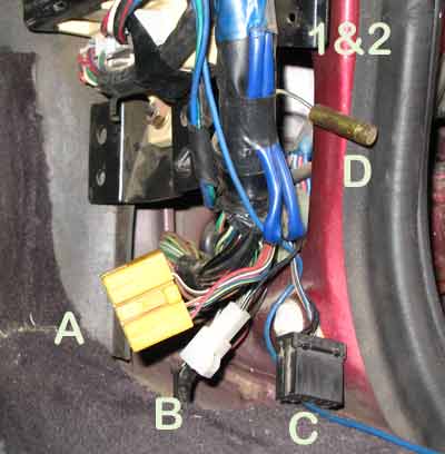

OK, first up
"Idle speed control"?
I thought this was dictated by the ECU, and was un-adjustable? (like it says under my bonnet)
As for
"Air-Flow Meter" I guess you check this from the code test plug(s)?
I've never been game enough to try plugging wires around in there 'till I'm sure what the hell I'm doing?
To that end I'll include a photo of my wire bundle, if you could confirm I'm supposed to use the ends of blue wires #1&2, to stick into orange block 'A'?
Arthur.

No, I wouldn't. I would remove the Drivers side lower crash panel and look for the 'D' check and Memory check connectors-One's green-thats D check, the othwer is Black-thats memory. As far as I know, to clear the codes if any without the select monitor, you need to connect both of these, ign on, put foot on accelator and car in drive for one minute. This will only clear codes if you don't have any 'hard faults' ie; no faults occurring during reset. AL memorised faults will be erased. ANyway, that's what i would be doing. the earthing of the diag connector is mainly used, (over here), for ABS and SRS diagnostic issues and I wouldn't go probing in there without a Genuine W/Shop Manual in front of me!!!
Sixpack

As far as testing the idle speed controller,
The inputs responsible for idle speed control are the Crank Sensor, TPS,CTS, aircon and power stg switches(if equipped), in your model, if it has climate control then the idle circuit actually runs through the CCM. Basically you want to remove your ISC and clean it. If it has failed it will throw a code/CEL. The problem with the ISC is that it has no 'return signal' to the ECU, so essentially, if the ECU is sending the signal to the ISC and the eng is idling above the pre-determined threshold to open the ISC, then it will not change it's signal. Basically what I'm trying to say is that the ECU doesn't 'actually' see what the ISC is doing, it just sees the results;ie;raised idle, leaner mix etc... SO the ISC may be getting the correct signals, but is unable to move because of carbon/build-up. As far as airflow meter goes, this is one of the few things that CAN fail without throwing a code. Probe the back of tterminals at the airflow meter with a multimeter. You should have a voltage at idle from the signal wire of around 1.7-2.2V. Just get it idling, start probing until you get a voltage, the raise the rpm slightly and see what happens to it.
What's the problem with the car mate?
Cheers
Sixpack
