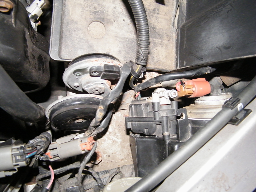

Well, discovered something ELSE that must be different about euro SVX... the horn.
Installed the pair this weekend (omg, car was a total snafu.) Took her out of the garage to find a massive gas leak. dropped a quarter of a tank in 4 miles. Shes sitting in the garage again...BROKEN. I dont have time to fix her this weekend... I will have to wait for June (no Reading for me)...Which means the car has to SIT... BROKEN!!! That is so often the beginning of the end for so many stored cars....
Back to the horn. The headlight level adjusters bump out alot from the back of the housings. The fender side horn is in the way. had to do some fancy moving about to get it all in there. (I pulled the harness from the zip snap close by, and put the twin horns back to back, out of the way, on the same original bolt).

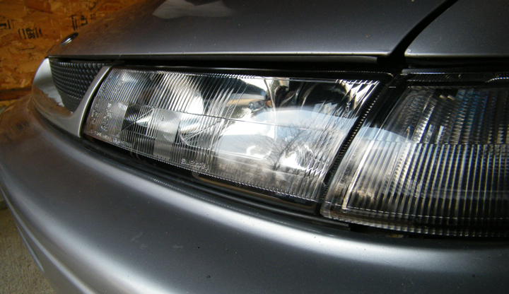

Here is the car after the weekend. Had to leave her parked b/c of the leak. It was a nightmare getting these lights in. (I broke the foglight reflector, and had to get another)
But I think these pics will make me feel better......as you all wish you had my lights
You can see in this pic, my projector got dusty some how when reassembling... will need to get something in there to wipe it off somehow.
Yes..my low beam is out on the passenger side...I use 9005 in 9006 slots, and that bulb wasn't modified yet. Notice the foglights. I get to claim 1st set of glass headlights w/ fogs?

My battery is out, as the car wont be moved for some time. You can see that the horns had to be moved (there is still space for the battery). The silver screwed thing is the motor. which mounts right onto the american housings. The plastic holder for the american adjuster is in view, not being used. This is actually on the euro models too, and is also unused.

Looks great, nice job!

now u just need the clear corners.....
very nice. hope u get her fixed.

clear corners? as in the smallcar performance ones?
nah
I think I'll keep my brand new (also known as not used) JDM corners.
You can see there is no orange reflector in pic 3.
I want a euro svx horn.

The look nice. That's a bit of a blanket statement, though. Don't you think? I don't wish I had your lights. Mine work just fine.
I second what Mike said.
I am happy with my brand new OEM lights and HIDs. You could use some of that ching you'd get from selling them to fix the gas leak or to get a new grille. jk

I think they look great. The only concern I would have would be potential condensation inside the housings after you took apart. Of course, they may not be any worse than our stock lights. No matter what anyone above said---glass headlights look infinitely better than our plastic ones--even if new.
I don't like the smallcar grille, however. The 97 or a JDM grille look sooooooo much better.
