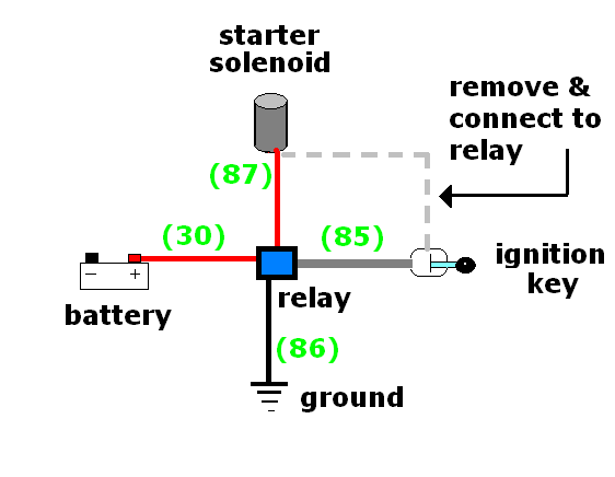

I can't find a Complete diagram of it exactly. Now mind you I no longer have an automatic so the N P is not there either. The inhibitor relay is not there either ( I don't think it is )
If I go to a Mechanic he will need exact instructions. I see the pictures but do not understand it completely. B/Y wire is original blue wire is 12v power. Black wire goes to ground and then what? What relay terminals go to what wire?
I searched for the diagram. After searchin for quite a while i found it . To help people to find it I am reposting it here
  #111
Old 09-19-2013, 03:46 PM
dannmarr's Avatar
dannmarr dannmarr is offline
I work for my SVX
Location: Pocono Lake, PA
Posts: 1,647
Re: NO MORE CLICK click CLICK START..ONLY START! starter relay
Here is a simpler diagram.

  #112
Old 09-21-2013, 06:05 AM
Dotted line was missing on the 1st diagram and I had to Assume that was implied but not stated. THANK U !

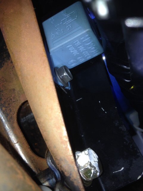

Old 10-03-2013, 07:20 AM
That was the wrong relay. After turning on the turn sig I found
Out that is the flasher. I have found it. Mine is way up further
See att

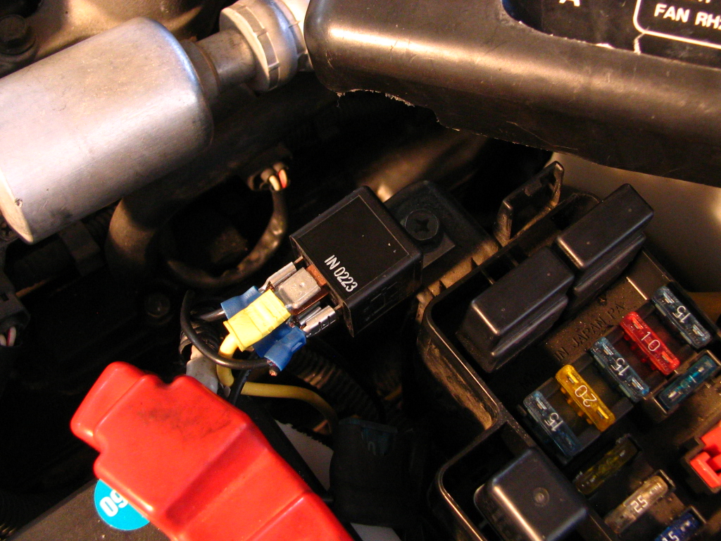

I also added a hidden security switch as a theft teterant.
I see where someone had wired up a start relay, I wasn't all that thrilled with the install so, after I thought it though some, I came up with my own. Problem fixed, I hope this helps someone.

  #120

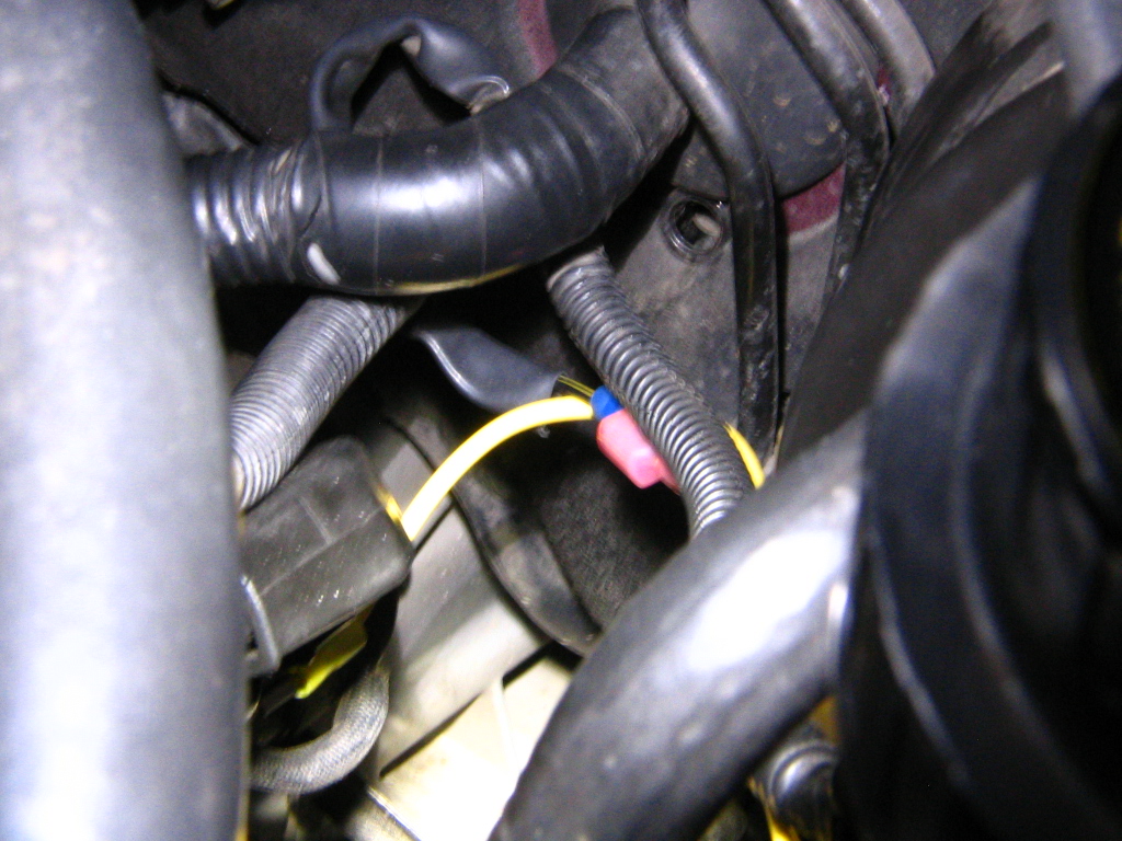

Posts: 1,647
You can mount the relay near the starter. Hook up the 12v from the starter post and the ground on the firewall.
