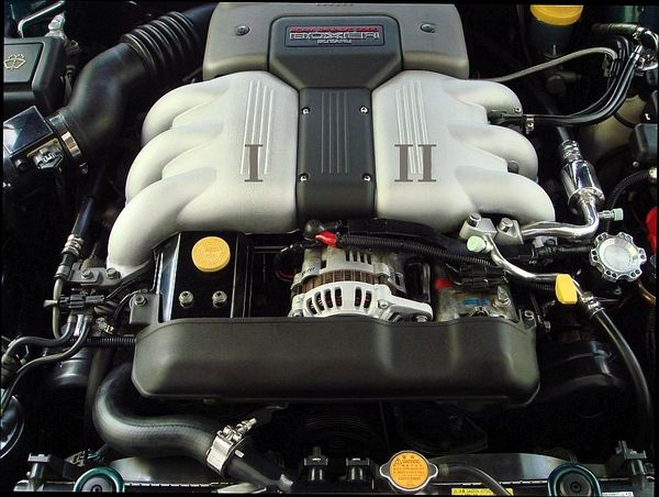

In the USA, for the six cylinder H6 engine, Bank 1 is on the passenger side, Bank 2 is the driver’s side (left side as you sit in the car)
If you are in front of your car, looking towards the windshield, then bank 2 is on your right.
