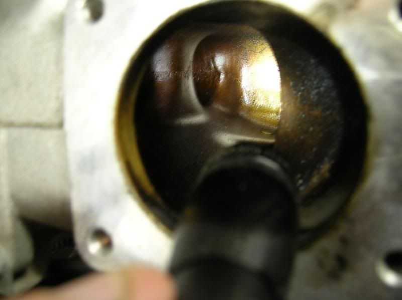

Ok, so I need some opinions. I got the motor out today and there are a few things that have me a bit concerned.

There appears to be quite a lot of oil in the intake manifold. Is this normal? Should I be concerned? And what's the best way to clean it out, or should I even clean it out.
Sorry for the poor pictures, it's hard to get enough light inside without confusing the camera

The oil in the intake is from the breather for the valve covers-Somewhat normal occurrence and more normal with higher mileage and age.

I'm betting most of the fluid on the top of the motor is from a leaky O-ring on the PS tank.....
I already replaced that a while ago, and it doesn't have even the slightest hint of red color to it that I would expect from ATF.

PCV valve or IRIS check valve?
+2
