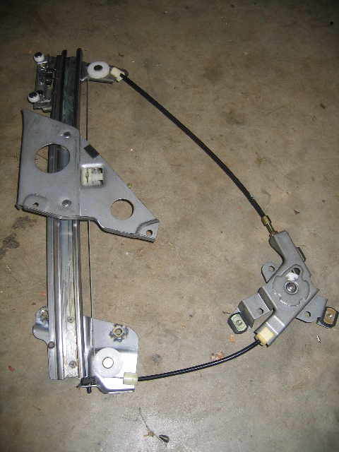

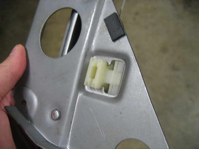

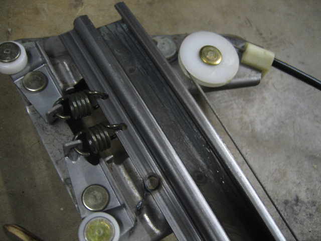

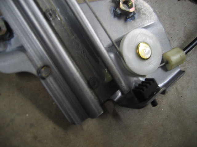

I really don't have a good mental picture of how the mechanism works. Too much is obscured by the door's superstructure, etc. I just looked for diagrams on SubaruParts.com, but what I found wasn't helpful. A good schematic of the window mechanism and how the cable is routed might help.

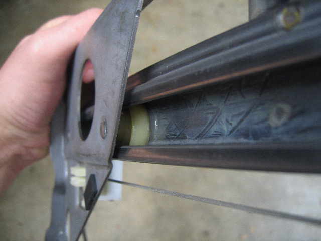

There is a vertical rail-like metal piece that has a squared-off C shape in cross section. The open end of the C faces the exterior of the door, and the closed back of the C faces the interior of the door. The interior of this piece would make the perfect track for a little plastic wheel to run along. I can't see down through that interior because this piece curves along with the door's curvature. Does anyone know if there is a little wheel like that inside? If so, maybe that's what'a causing the noise.
Old 02-22-2007, 07:47 PM
immortal_suby's Avatar
Thread Killah
Location: Greenville, SC
Posts: 5,835
this should help
whole assembly
rail and plastic roller
lower pulley
upper pulley
sleeve lock regulator
Locker Link
2015 BRZ Limited 6MT

Thanks again Matt and Earl! Now I can see that there is a plastic wheel inside the rail, like I imagined. I really hope a little silicone spray will solve the problem!

I bought some silicone spray, and today I finally tried it out. It didn't help at all! I used a lot of it. I also used a lot of WD-40 (assuming there's a difference) for good measure. I sprayed down the rail's interior as best I could from the top and limilted access from the side. I sprayed down the interior wheel several times when it was close to the top. I sprayed the pulleys and the cable and some of the rail's exterior, and even that thing with the 2 springs on it that sits on the opposite side of the rail from the cable. (What does that thing do?? It doesn't make sense to me!) I ran the window up and down repeatedly. If anything has changed at all, it's gotten worse. I think the window may be starting to have trouble going up. The sound is almost like a ripping noise. When the window is almost near the top, I can hear a popping noise. With the door panel off, I can see that the cable snaps, as it plucked when this popping noise occurs, and the window jolts. (Actually, the movement of the cable may be a result of the jolt, and not the other way around.) The mechanism looks too simple to have something else going on to cause this problem. I really can't explain it given my understanding of the mechanics. But there's a lot obscured from view, so I'm guessing that it's more complex than it looks.
